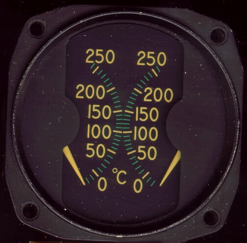

			If you don't mind doing some scrounging through dusty parts bins ... you can sometimes find some good deals on military surplus gauges at dealers like GEM Aircraft Supply in Dallas!
			This one was for a Boeing B-50, and cost me $10! It also has a decal of the complete gauge circuit on the side, and uses the same thermocouple probes Westach or Aircraft Spruce sell!

			So what is too hot for the CH temp?  200? 250?  300?
			Join Date: Mar 2000
				Location: Irvine, CA
					Posts: 1,200
 At least on Type IV's, CHTs normally run around 350-425 F, from what I recall. I'd think a 911 would be similar.  |

			Jim is correct. Don't ever confuse CH and oil temperature. The heads run a LOT hotter, hence the quick damage from lack of air-flow(broken fan belt).
 Nonetheless, I would like to get a CH tempt guage with the red in the right location. Anyone know the limits?

			Warrens gauge is in Celcius... will work fine. If it works on a B-50 (a improved B-29) radial motor, then a 911 is no different. Joe

			I don't think it's useless, the scale goes from 32F to 482F.
			Plus it adds that boneyard, cold-war cool! All he needs now is an "eyebrow" or "post light" to illuminate it at night. Also, it's a hell of a lot cheaper than a TSO'd, or even experimental grade version. http://www.wpafb.af.mil/museum/outdoor/od17.htm VDO makes one also, if you really wanted to you could have North Hollywood Speedometer silk screen a "Green Arc," "Yellow Arc" and a "Red Line" on the gauge, depending on the specs from your particular model. http://www.nhspeedometer.com/cockpit_page1.htm (Scroll to bottom)
