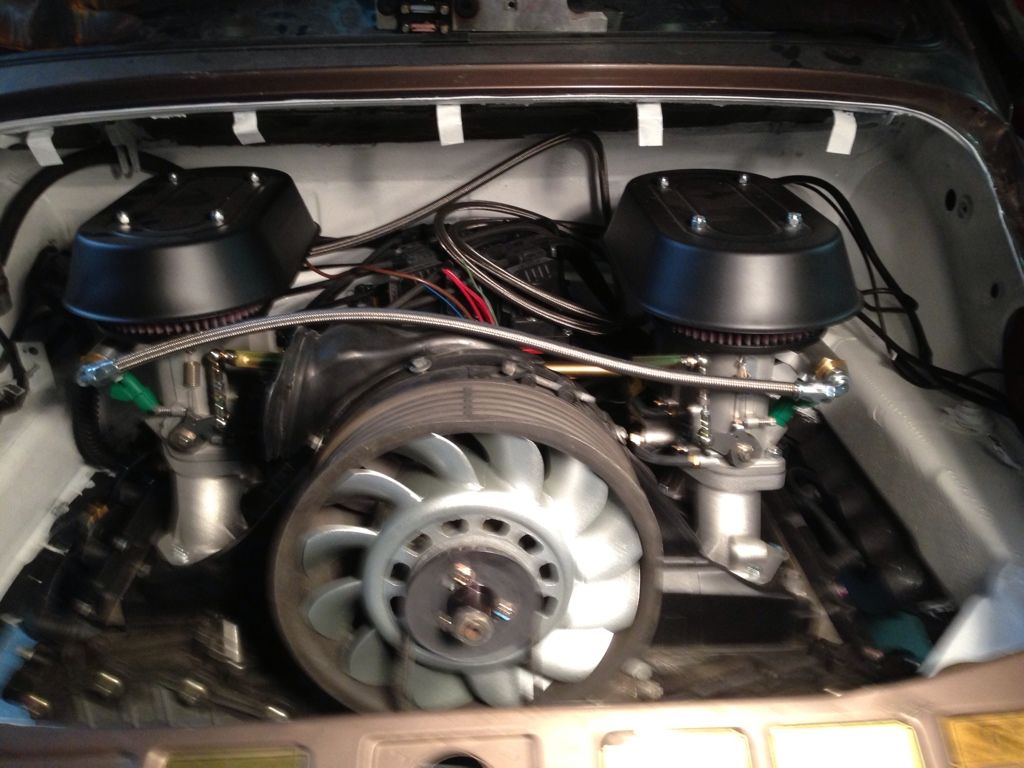

Source for ITB air filters
Here is a picture of the 3.6 in my 74 RSR clone. The rain hats just don't look right. Is there a good source for individual filters that fit the PMO velocity stacks?

here's a couple of sources for you.
regards,
Al
Automotive | Uni Filter
Mini Sport USA Trumpet Socks - by Mini Sport USA, the Worlds Premier Mini Specialists
DCOE AIR FILTERS 40 45
RGruppe #669
http://www.x-faktory.com/

Air Filter information
We use these on a few of our installs. We have laser cut aluminum bases to fit different carb configurations. Sometimes they need to have a slight offset to clear things like the MFI pump or right side moved forward slightly so the top rear portion of the filter does not touch the engine lid grill. We have also spaced the rear engine mount down slightly to gain clearance. The racing tailbases usually have no clearance issues. If your not running in the rain, these work great. The are coated with a spray oil, so it would be interesting to see them get wet. They may repel water. Honestly, I've never seen one wet.
We have a 3.6 engine with PMO carbs. on the dyno now without air filters. Tomorrow I will know what that engine gets.
I would not do your final fuel map tune until you get the filter on the engine that you will run.
