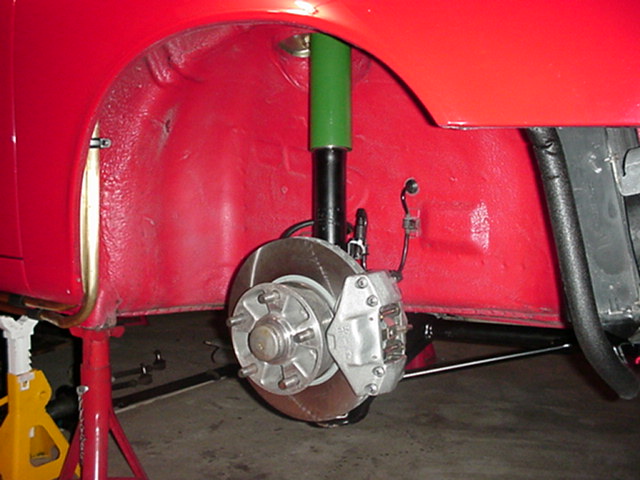

Kevin - doesnt Waynes book tell you to put the jack stand right on the spot that has two of the three bolts that you have to remove to take them off? I looked at it last night and your right...easy 3 bolts, but where to move the jack stand? I can access the bolts with the car on the ground. Is there a reason not to do it with the car on the ground?

Yeah the front a-arms will fall onto the ground., if you don't lift the car and support it with stands. That's why you jack the thing up and hold it up with jack stands. trust everyone on this.

Matt - where is the best place to put the front jack stands for support?

Here's where I place the jack stands (ignore the yellow jack stand, it's just supporting the oil cooler lines because I didn't have the lines completely bolted in place at the time of the picture):
