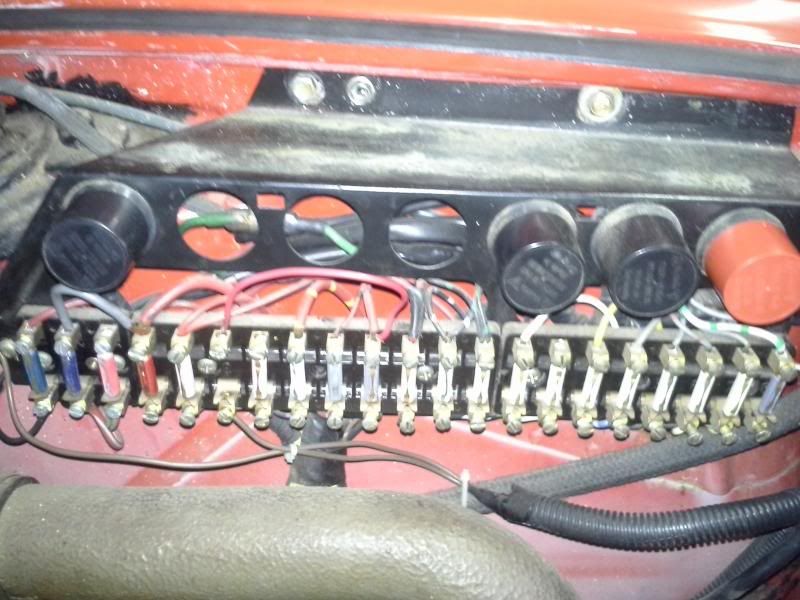

OK so my fuel pump stopped working and I got digging around looking at fuses and wires. The box cover shows the fuel pump is the blue one all the way to the left in the pic. It is not blown. I followed the wires from the fuel pump and it goes to the sixth spot from the left. That fuse is blown. Cover says that's for the a/c. It has wire coming from spot 10?
Also the 4th fuse is blown. That also has a wire going to spot 2.
The car is pretty new to me. Not sure what's going on here.
Anyone know why this would of been done?
I did find the wires going to the pump were chewed on my mice. Must of grounded and blown fuse.

Did you check relay red one check the fuel pump if not seize And i would check for wire diagram you have some mixe up wire.Would be helpfull to put what year and check part number in coverif you have the right one.

Thanks. It's a 76. Good point on checking the over part number. I'll be looking up wire diagrams this weekend.
