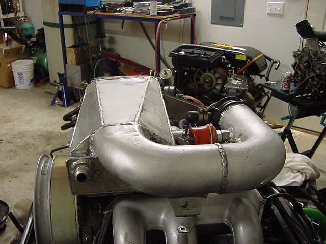

Water to Air 930 Intercooler
Well guys .... here is a water to air intercooler setup that I acquired but have yet to install. It is still with the engine. Comes with the entire 3.2 EFI setup. Done by an understudy of Bob Norwood http://www.bobnorwood.com/ in Texas. Fabricated to ride on top of the 3.2 intake manifold with plenty of room in the engine bay. Has a separate water radiator, water tank and water pump. Was originally in a 930S flatnose. With Haltech 9A Engine management ECU, 964 cams, twin plug it dynoed at 620 RWHP.
The complete motor with everything attached is up for sale and if it does not sell as a package we will probably sell off the Haltech intake\injection & intercooler as a package separately apart from the remaining engine

The 934 had a water to air intercooler. The water radiators were in the front valence.
PB
