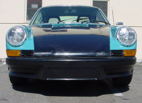

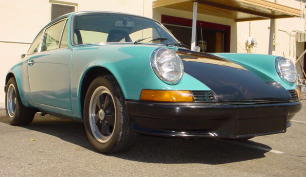

The RS fiberglass parts are on the car and the fitting is nearly complete. The parts all took a bit of work to get a proper fit. I read with envy about PBS911's experience with a "bolt on" hood.
Not the case here. It took trimming, bending, glassing, pushing, proding, pissing and moaning to get a good fit for each of the four parts. I still need to do a little more to get it all just right, and I haven't even started the paint prep yet.
Here are a few pictures:
The sun was bright so the black bits in shadow are a little hard to see. That's a standard RS front end.
The good news is the fat has been dropping off the car in big, beefy, moist chunks. Here is the tally (from memory and some are estimates):

The difference is very noticable. The car is almost 10% lighter and it shows in every performance dimension - acceleration, braking, turning. The car feels very tossable.
Although the pictures don't really show it, the car's ride height is very high now. It looks like it's on it's way to Dakar.

Well Paul, I guess that makes me feel a little better. Also the early and late bumpers are not comparable in terms of mounting.
I did have to do a fair bit of trimming on the hood though. And I had to machine a bit of extra adjustment range into one of the hinges to get it low enough.
The front bumper was the poorest fit of the bunch. It was too wide at the fenders and needed to be tensioned a bit to get it to line up. I've seen plenty of other RS FG bumpers that had this same problem and the owners just let it sit wide. I'm just a picky bastard.
The rear bumper fit well with just a bit of trimming. However I had to glue and glass the supports to the piece myself and that took time.
The tail was a bolt on. However the gaps are a bit large for my picky bastard eye. I am going to fix this.
