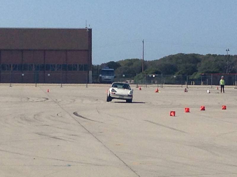

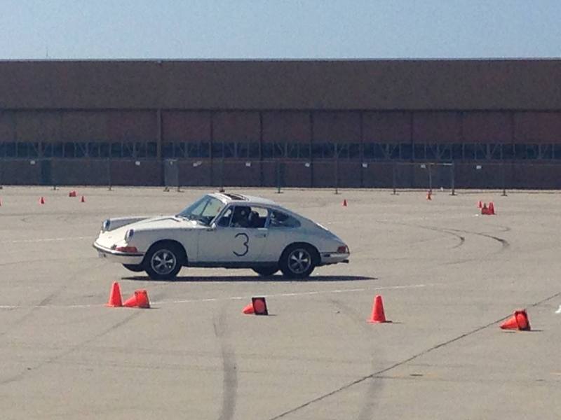

I did my first autocross a couple of weeks ago and my car was the slowest and most entertaining at the race I'm running a bone stock - comfort group - suspension with stock euro ride height and toe/camber/caster settings.
Here's what it looked like:
I have my hands on a full set of torsion bars from an 88 930 - 26mm rears and the 18.8 fronts. I also have the Koni front strut inserts from the same 930. I will be installing the rears, but I'm not sure about the fronts - is there a benefit to installing the same size bars that are 20 years newer?
Does anybody know if the valving is significantly different between the stock Koni shocks for an early 911 and the 930 shocks? Is there a benefit to using them?
The car does not have a rear sway bar installed, and the local PCA racers tell me that it isn't really needed on my car... comments? There is a front through body sway bar - it's got three adjustments and is presently on the middle setting. Would it help to make it stiffer or softer?
Finally, I'm planning on lowering the car - local recommendation was 30mm. Any other thoughts?

Wow! That looks scary, That is almost a "dual-pod"
A rear anti roll bar, 26mm rear t-bars and fresh shocks is a good start for an early car. After that the slope becomes steep...

Believe it or not - that was not an out of control situation. I was hard on the throttle,which is why both back wheels are on the ground, and understeering while running for the finish line. They had the course set up so that there was a long fast right then a very quick left and straight on to the finish. That's why you see the "up" wheels switching.
It was fun, but pretty slow.

Took a few minutes to think about this, and I'm going to take a crack at what I think is going on.
DISCLAIMER: I'm early on my quest to understand suspension, so any percentage up to and including 100% of what is about to spew from my fingers may be incorrect. There are at least 3 people on this board who actually know this stuff, so hopefully they will chime in.
I think what we are looking at is a phenomenon called jacking. A suspension of a car has a roll center. It's like a pivot point that a call rolls around under lateral load. A car also has a CG, which is a way to simplify where the mass of the car acts. What you end up with is a lever with the mass trying to lean the car roll center. I believe this is called the roll couple.
Normally, suspensions are designed with a roll center around ground level or slightly above. I think I read this gives the driver good natural feedback as the car leans.
Problem is, while the CG stays the same, the roll center is dynamic - it changes with suspension deflection. Also the rear has it's own roll center, and a line between the f&r creates your roll axis. I don't know how the rear trailing arm roll center is calculated. But with the MacStrut front, the roll center lowers as the suspension compresses, and raises as the car raises.
Now you may be thinking, cool. If you raise the roll center to CG height the car will not roll at all, and that will be awesome. Problem is, when the roll center gets too close to the CG, the car exhibits jacking where it lifts the whole car. Old swing axle Triumphs were famous for this:
I think your front end is jacking. I think your aftermarket front swaybar is too stiff. I think it's not allowing your front end to compress, keeping your front roll center too high. I think the front of the car is just sort of tilting over, rather than rolling over and biting in.
I have the same suspension design and geometry as you, and bet I'm putting a fair amount more lateral load on the car. I have a lot of roll going on, but the car is hunkered down on those outside tires pretty good.
tl;dr if I'm right, there is more than one solution to try:
Easiest and cheapest is to soften that front swaybar. May seem counter intuitive when it seems like you have enough roll already, but as soon as that inside front is up it can't transfer any more load than it already is. I bet if you soften the front (move to the outer most holes) the front will compress and bite better.
Another option would be to lower the car a bit. I'm no expert, but it looks a little on the high side for performance purposes. If you have room on the front adjusters, you can give them a quick turn or two down the morning of an event. If you count your rotations, you can put it right back to where it was after the event and go back to your original alignment.
Next plan of attack would be to reduce the total roll. You'd have to go after the rear, as the front is apparently giving beyond all it can. That means more rear spring and/or adding a rear swaybar.
