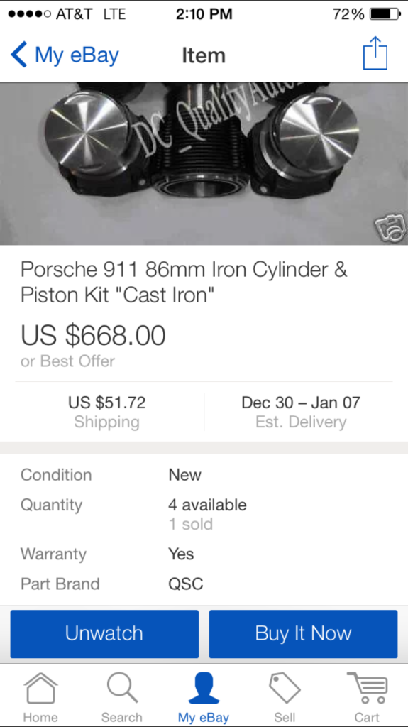

Iron Jugs?
http://i1237.photobucket.com/albums/...psxgvv23o8.png
Lapkritis 12-26-2014 11:33 AM
QSC - expect to require work to fit. They dimensionally are correct except for the external width so you'll need to shave down the fins. They use snap rings to retain the wrist pins and the pistons are not as pictured; they're cast CIS replica.
A&F 12-26-2014 11:53 AM
Something to avoid? I'm shocked at how, "affordable" they are.
All I've found so far is that iron cylinders weight 30lbs more total and heat differently (good way or bad way?).
