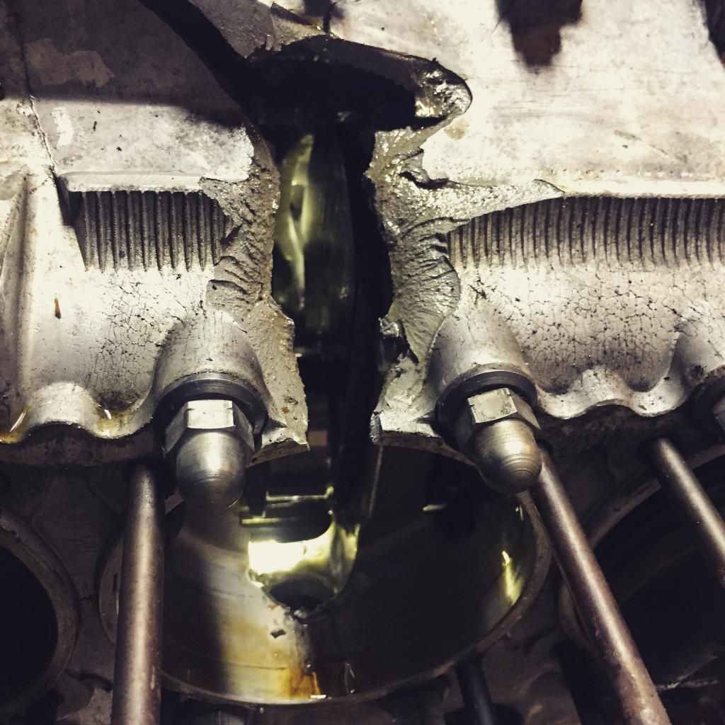

Rod bolt failures from a previous overrev some time in the past that stretched the rod bolts?
db_cooper 12-16-2014 06:32 AM
If there were some manufacturing defect the Porsche engine won't go 100k miles..so why would a 3.2 ventilate the crankcase? I have rebuilt many 911 engines with much more than 100k on them with absolutely no rod/main bearing wear..if the oil is changed regularly.
If for certain the 911 engine had never been opened up or rebuilt..then the only answer is an oil pressure problem, too long an oil change interval, low oil level (starvation) or hydro-lock....due to the cylinders filling with fuel due to a temp sender or DME problem..engine started and then bent a rod..they will grenade shortly thereafter:(
Don't think an over-rev is the problem..although I have seen engines that broke because the driver dropped into a much lower gear than intended and released the clutch...the engine will break..911s don't like 11,000 rpm+. Usually the valves are bent first..a sure sign of over-rev if a rod is punched through the block too.

Walt Fricke 12-16-2014 02:42 PM
Engine cases can be welded. Whether that is economic or not for a given model is a different issue.
Lapkritis 12-16-2014 03:33 PM
^I second what Walt states. It'll need full machine service after welding is done; align bore case, spigot decking etc.

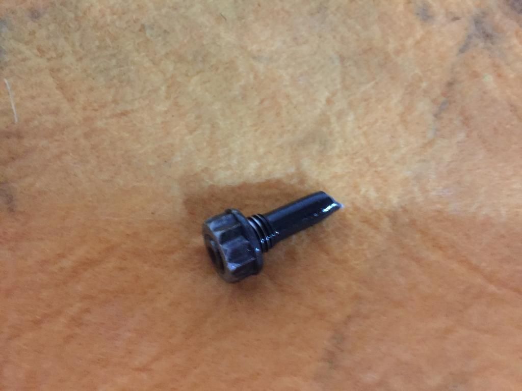

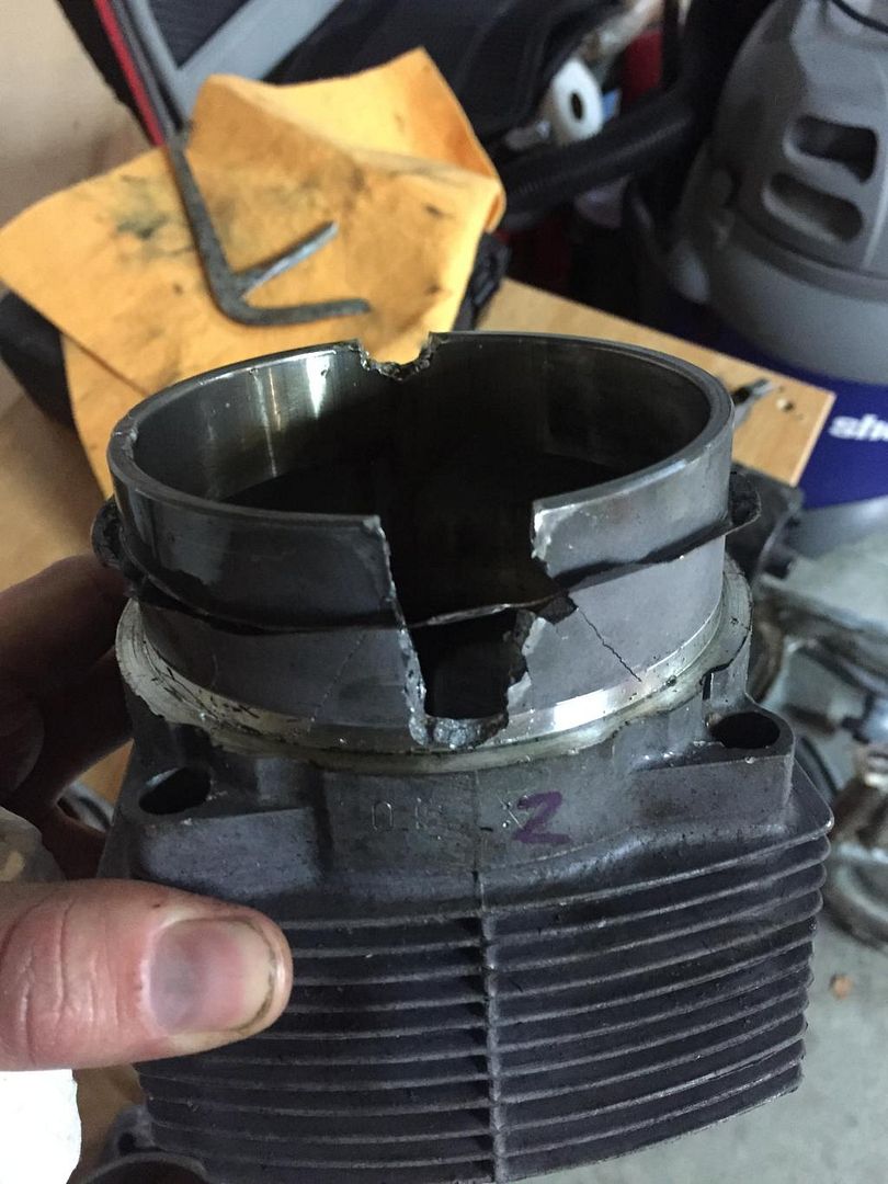

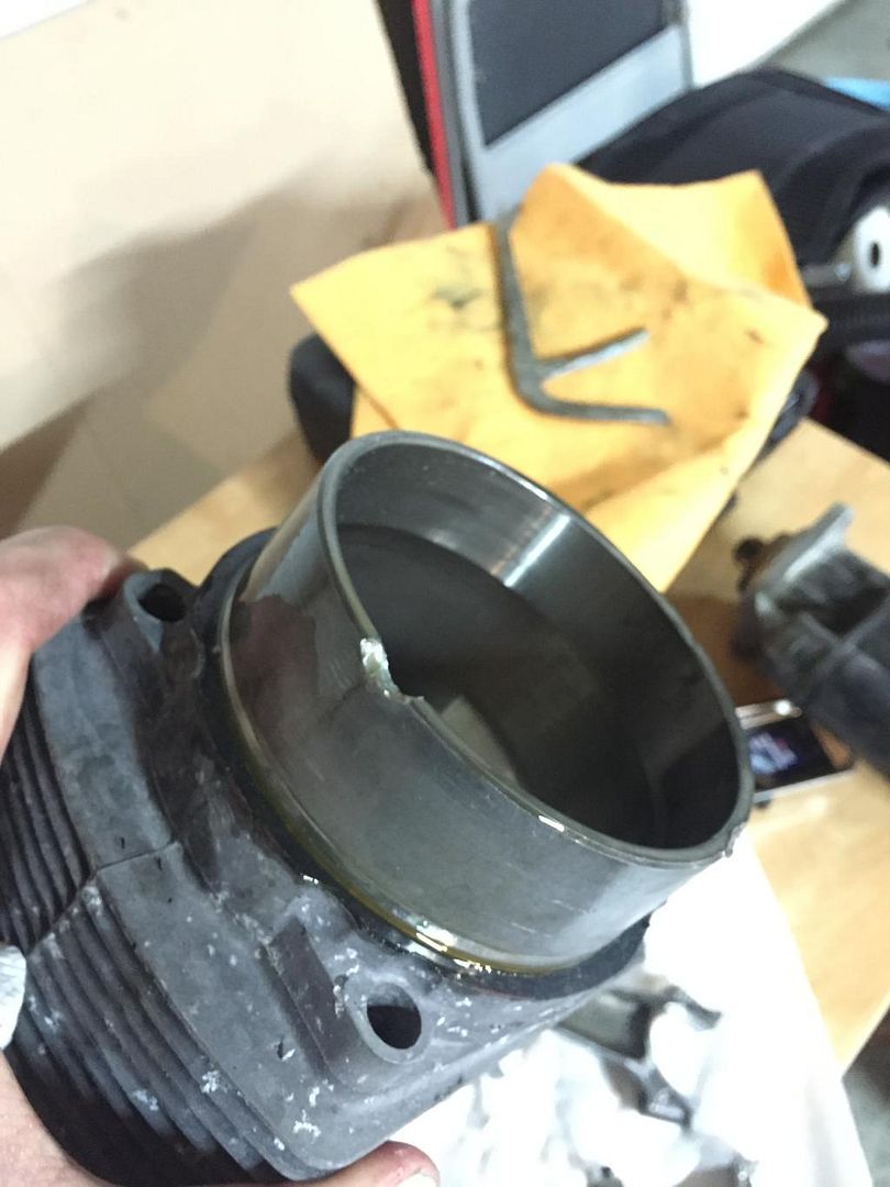

Casualty Report:
Micro knick in Crank, Salvageable
2 Rods, total loss
4 cylinders, total loss
3 pistons, total loss
1 case, total loss

A&F 12-24-2014 01:02 AM
Carnage:
http://i1237.photobucket.com/albums/...psq5whty2v.jpg
http://i1237.photobucket.com/albums/...psmaixvklh.jpg
http://i1237.photobucket.com/albums/...pscf81gsf7.jpg
http://i1237.photobucket.com/albums/...psx2wb8l9g.jpg
http://i1237.photobucket.com/albums/...psuuzqrylb.jpg

Dan J 12-24-2014 06:16 AM
Did that rod have a spun bearing? It kind of looks like the bolt broke
Were there rod bolts charged on the engine rebuild bill?
VFR750 12-24-2014 07:24 AM
Rereading your original post, and looking at the bent rod cap, it suggest you may have broken one rod bolt earlier. The noise you heard may have been the rod cap smacking the rod on each stroke. Since you shift at 3k or so, the one bolt was probably strong enough. As soon as you blipped it, it was overloaded.
Just a possible scenario. Did you find the other rod bolt? Was it pulverized? That would support my theory.
Regardless, a sad, spectacular, failure. Devastating.

jlex 12-24-2014 07:36 AM
Almost looks like you've been hit with an armor piercing round. Scary.

A&F 12-24-2014 08:23 AM
Wow that's a lot of damage. Hoping to start on mine next week. After the engine blew up how long was it till you shut it off?? What are your plans now?
Less then s second. The car was not moving.
A&F 12-24-2014 08:25 AM
Did that rod have a spun bearing? It kind of looks like the bolt broke<br>
Tool marks on the hardware indicate the same bolts where reused. The bearing did not spin.
Had to turn the engine over a few times before finding any damage to the crank.
