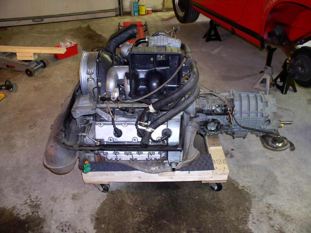

Well, for what its worth, I built a quick custom engine "dolly" for mine, and spaced it off the floor such that an ATV jack that I picked up at Sears can roll right underneath it. Very stable, really slick. I got the casters for my dolly for free and floated about $120 for the jack. Keeps your regular jack free to help lift the car any extra amount necessary too.
I pulled my clutch arm off as it was accessable and probably easier to do while the engine was still in the car.

Here it is...

That looks great! Would you mind sending us all dimensions so we can build our own?
