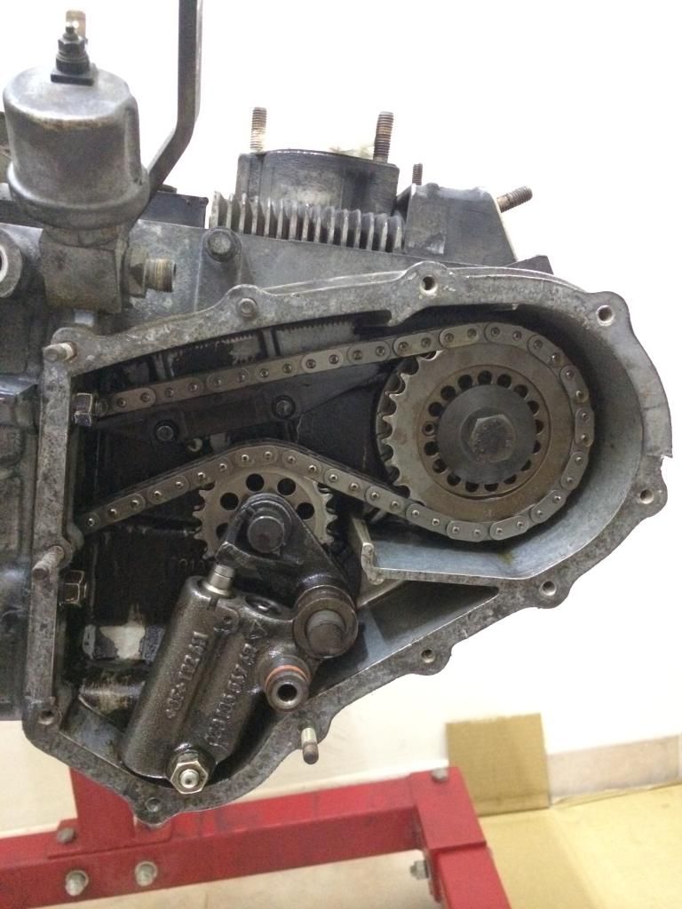

Still moving slowly and methodically through the teardown process. I removed the crankcase breather cover, oil pressure sending units, tstat, oil cooler, cam oil lines, and front chain housing cover. Everything went smoothly except some of the studs holding the chain housing cover came out. I need to wait for the cam holding tool before I can proceed further.
http://i306.photobucket.com/albums/n...psd9m9o7ep.jpg
http://i306.photobucket.com/albums/n...psweovce3d.jpg
http://i306.photobucket.com/albums/n...psq2rmd7f3.jpg
Tomorrow I'm going to raise the front of the car on jackstands, give it a good wash, remove as much stuff from the engine bay as possible (MSD, oil tank, oil filter/accumulator) and scrub the area down. I will also try to drain the fuel tank. I want to paint the engine bay area black to get a cleaner look, and also remove and clean the fuel and oil tanks and repaint if necessary.
Hopefully I'll be able to get all new fuel lines from one of the members here, as well as a new wiring harness.
