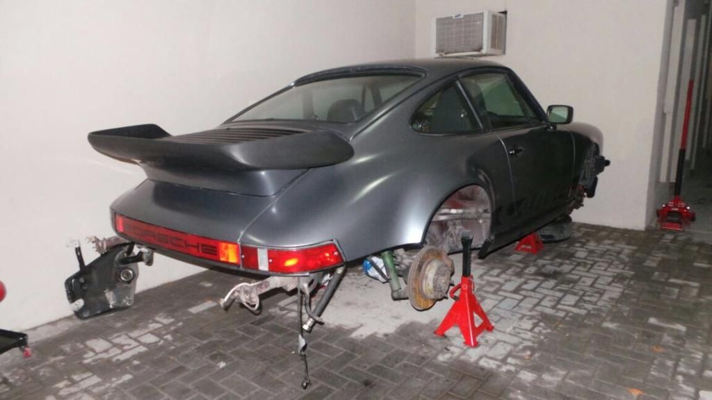

Well, continuing from my newbie engine drop which was relatively painlesss ( http://forums.pelicanparts.com/porsche-911-technical-forum/823477-true-newbie-engine-drop.html ) I move on to the teardown and rebuild thread. I apologize in advance as my terminology is weak and simplistic :)
This is where I left off
http://i306.photobucket.com/albums/n...psrbomklca.jpg
To start off, I have read through the books by Wayne and have all the appropriate tools for the majority of the work. The special porsche tools are on the way. I am bagging and tagging and labeling and taking pictures so hopefully I have everything sorted and recorded.
I started today by removing the fuel injection system (the top half of the engine) while it was still on the ATV jack. The process is straightforward, however not as straightforward as the books suggest. I thought I'd remove 12 bolts and it'd be off, but you need to unplug certain connections (mentioned in the books) and label them and make sure you clear the harness out of the way. You also need to disconnect the oil hose which is directly under the injection setup. Once that was cleared, the whole thing just came of and I put it on the shelf.
The next step was removing the exhaust, so when my buddy arrived we jacked up the engine onto the engine stand. For the record, I am using a generic stand adapter which works perfectly fine.

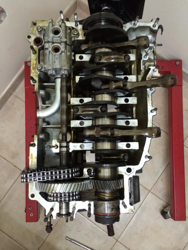

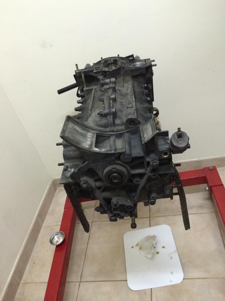

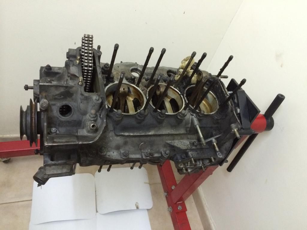

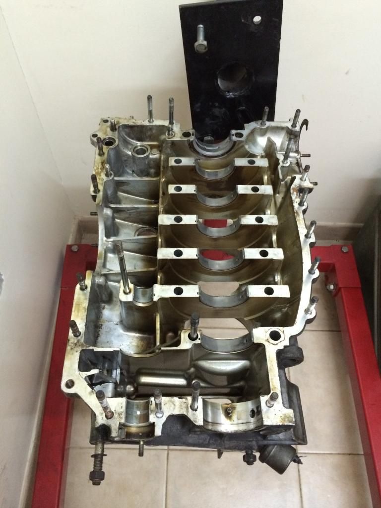

Still moving slowly and methodically through the teardown process. I removed the crankcase breather cover, oil pressure sending units, tstat, oil cooler, cam oil lines, and front chain housing cover. Everything went smoothly except some of the studs holding the chain housing cover came out. I need to wait for the cam holding tool before I can proceed further.
http://i306.photobucket.com/albums/n...psd9m9o7ep.jpg
http://i306.photobucket.com/albums/n...psweovce3d.jpg
http://i306.photobucket.com/albums/n...psq2rmd7f3.jpg
Tomorrow I'm going to raise the front of the car on jackstands, give it a good wash, remove as much stuff from the engine bay as possible (MSD, oil tank, oil filter/accumulator) and scrub the area down. I will also try to drain the fuel tank. I want to paint the engine bay area black to get a cleaner look, and also remove and clean the fuel and oil tanks and repaint if necessary.
Hopefully I'll be able to get all new fuel lines from one of the members here, as well as a new wiring harness.

I'm still waiting for my cam holder tool, so I decided to try cleaning my transmission and other parts. I couldn't get my alternator and fan out of the housing, and I also noticed that my housing has cracked :(
http://i306.photobucket.com/albums/n...psddx2ftoh.jpg
http://i306.photobucket.com/albums/n...psuimvscfc.jpg
I'm going to do some research on way that I can get the alternator out!
Meanwhile, my transmission came out nicely after some engine cleaner and pressure cleaning

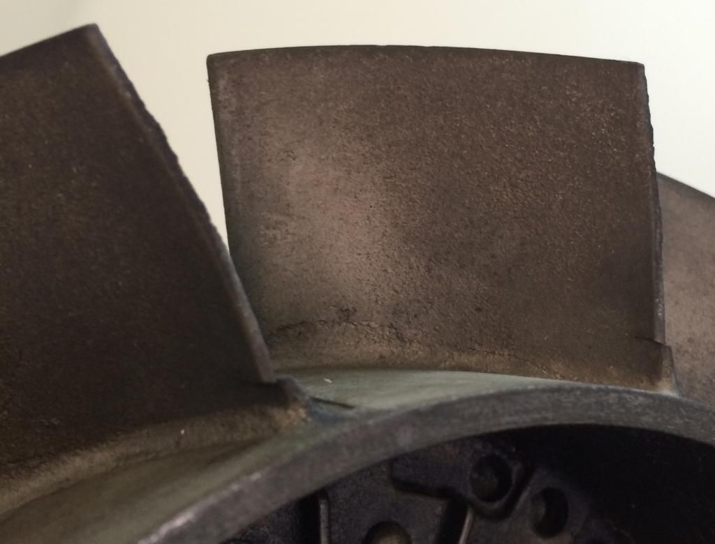

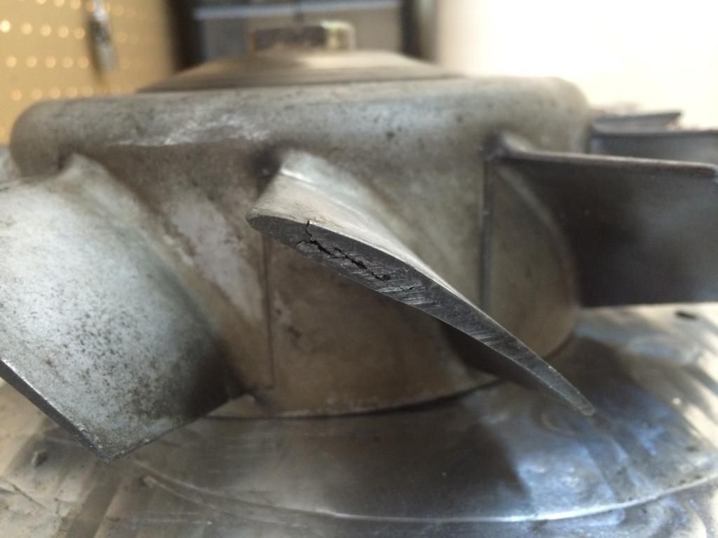

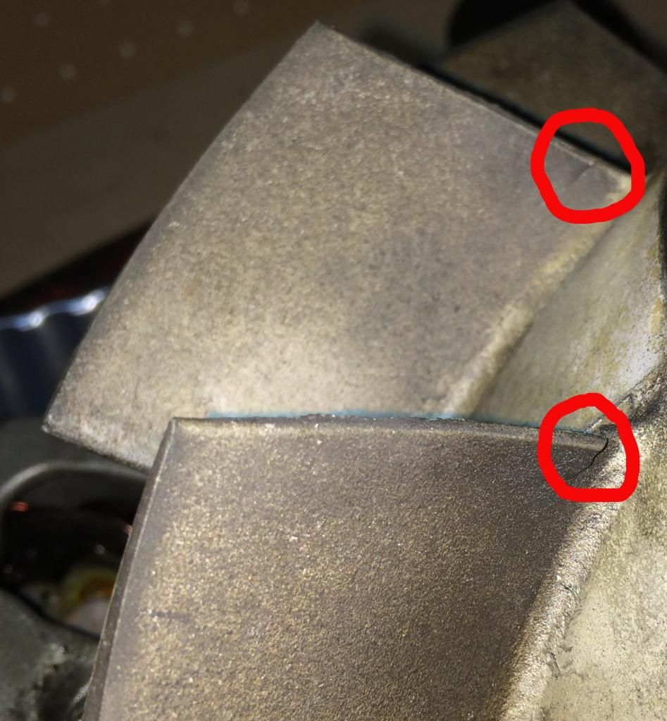

GT2BH 08-23-2014 01:48 AM
I used Jim Walkers method for removing the alternator and fan and it worked perfectly - http://forums.pelicanparts.com/porsche-911-technical-forum/60368-fan-hsng-alternator-removal.html

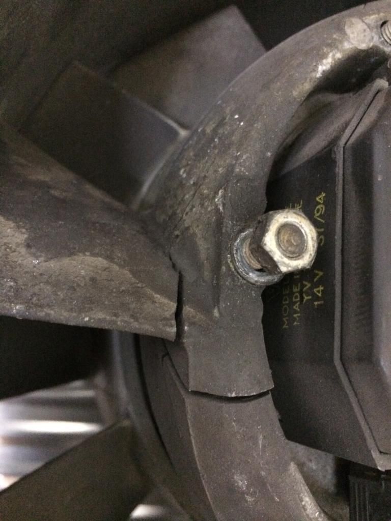

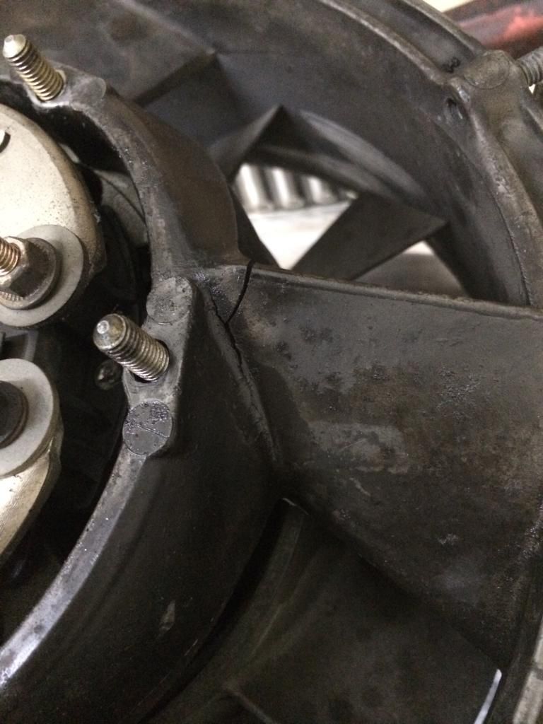

The housing will go in the trash, however do these "imperfections" on the fan mean I have to replace it?
2 blades have cracks
http://i306.photobucket.com/albums/n...pscccca93f.jpg
http://i306.photobucket.com/albums/n...ps8cc702ea.jpg
http://i306.photobucket.com/albums/n...psfy80y6cr.jpg
KTL 08-24-2014 08:22 AM
The fan is fine to keep using Don't throw away the housing. It's magnesium & worth some $ in scrap!!!
GT2BH 08-24-2014 09:17 AM
I've scrubbed the fan and will give it a quick DIY paint job with high-heat spray paint. I have a virtual garbage heap currently, nothing is going in the trash yet :D
The shopping list keeps growing, so I should re-use as much stuff as possible

Took the advice of the members here and as per the instructions from timmy2, I was able to get the cam gears, chain housing, cylinder heads, cylinders and half of the pistons so far. It's pretty straight forward taking things apart, I hope its the same putting things together!
I was reading through Wayne's book and it says for the later model SCs there is generally no need to replace the head studs. I'm thinking since I'm here I might as well replace the head studs.
Also, any advice on what cylinders and pistons I should be looking at? any advice on what my shopping list should include? I contacted John Dougherty about regriding my cams to 964 and got a reasonable quote.
http://i306.photobucket.com/albums/n...pskdp5c7tl.jpg
Some cylinders were filthier than others
http://i306.photobucket.com/albums/n...psmrcel3ry.jpg
fritzgator 09-04-2014 06:20 PM
PM sent
Smoove1010 09-05-2014 09:32 AM
Great progress! Sorry to be a nanny, but do cover any openings into the engine case while it's in this state of disassembly. It's amazing what can find it's way in through those many openings that might later clog some tiny oil passage or squirt-hole somewhere.

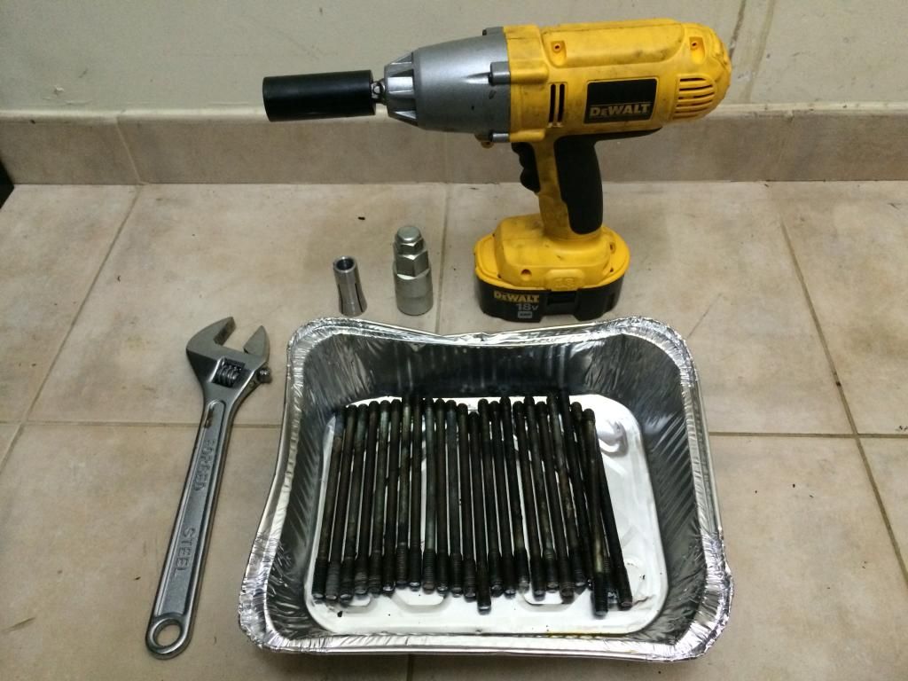

Today was the most rewarding day so far! I got the headstuds off with no major problems, thanks to the SnapOn tools. Had to hit one with the propane, but otherwise all of them went smoothly.. some went too smoothly and it made me worry that they were not properly torqued.. All I needed was this
http://i306.photobucket.com/albums/n...psio9prjpl.jpg
Also removed the main pulley, and all the case bolts.. was so close to splitting the case but I promised my wife I'd have dinner with her so it'll have to wait until tomorrow :)
Case ready to be split
http://i306.photobucket.com/albums/n...pspcsm7x1v.jpg
So much dirty.. I'm going to enjoy cleaning everything later
http://i306.photobucket.com/albums/n...psxlsatloa.jpg

Finally, I am done and the case is split and everything is out! Now I will read the next chapter in Wayne's book, start cleaning and inspecting all the parts and finding good machine shops to do the dirty work.. we don't have any local porsche shops so any recommendations of shops you guys are happy with will be helpful..
Are there any notorious problems areas I should be looking at first?
Should I start taking the camshaft housing and heads apart at this point?
http://i306.photobucket.com/albums/n...ps7zd3y0wr.jpg
http://i306.photobucket.com/albums/n...ps20pz21ol.jpg
GT2BH 09-06-2014 07:22 AM
I just noticed these scratches on the inside of the case, what could have caused them?
http://i306.photobucket.com/albums/n...pstvenwmpg.jpg
http://i306.photobucket.com/albums/n...psehitg3kp.jpg
http://i306.photobucket.com/albums/n...pso10qsnpl.jpg
