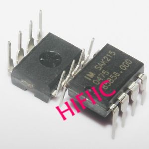

Thom.. Found this dangling thread when searching for something else... Here's what happened:
I went thu every internal tachometer component - every resistor, every capacitor.
Turned out to be the Pulse Shaper SAK215
$3.50 on ebay.
Some hard-won knowledge there.
BTW, I now have lot's of spares of every resistor and capacitor. :-/
