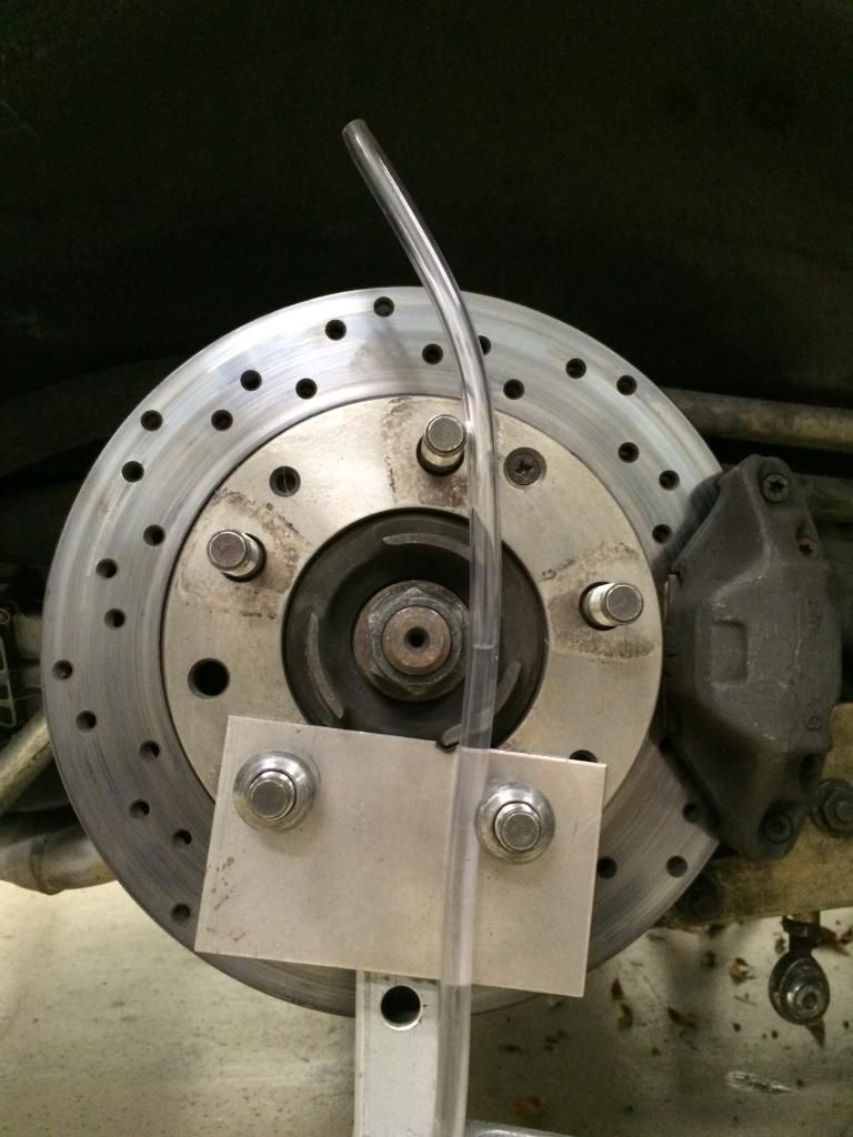

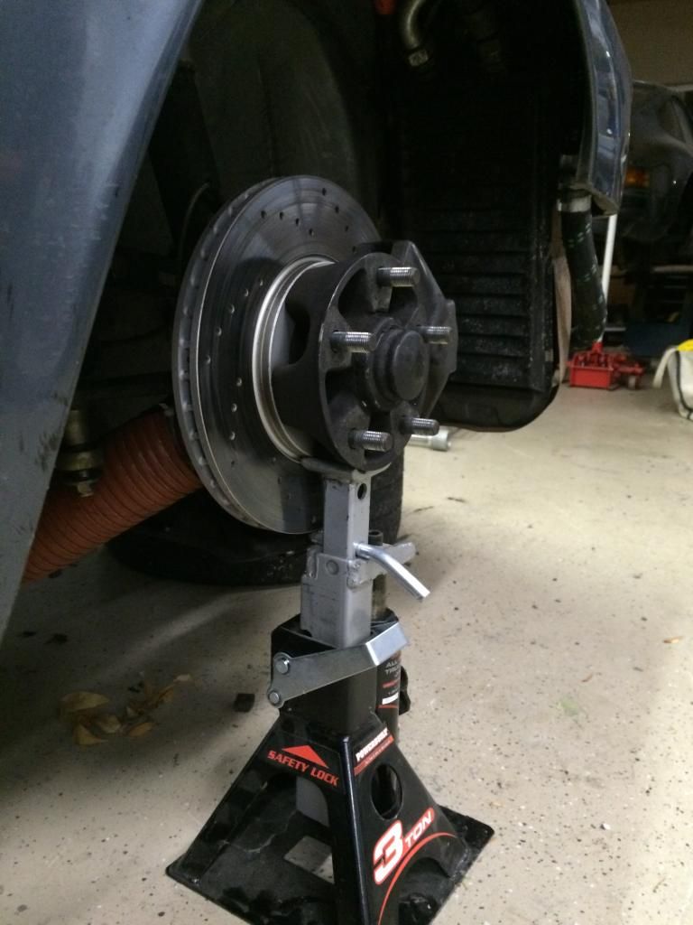

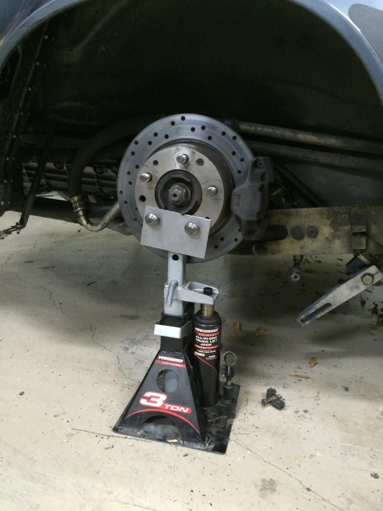

OK, a simple resolution. Drilled a steel plate to fit over two lug studs, creating a block for the saddle of the jackstand so it won't slip off the hub. Viola!
http://i109.photobucket.com/albums/n...8B6BAA1902.jpg
The front hubs are already sloped inwards.
http://i109.photobucket.com/albums/n...5DD3EED5F3.jpg
Now I can set level right at the center of the hubs with the water level, and the toe and camber adjustments should be much easier to reach. Toe and camber measurements can be taken right off the surface of the rotors.

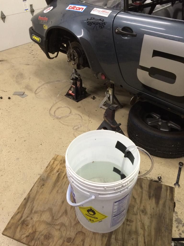

Can you show a pic with the water level attached?

Here's the bucket sitting on the lift table i use to drop the motor:
http://i109.photobucket.com/albums/n...6C1FEFF37A.jpg
and a closeup on the tubing showing the water level at the hub:
http://i109.photobucket.com/albums/n...3B62ACABCB.jpg

ZOA NOM 11-12-2014 07:25 PM
The only binding I see here is gonna be caused by the saddle of the jackstands as I adjust toe, but I'm only gonna want a sixteenth toe in on each side. Camber shouldn't be a problem as it leans, and the spring plates are ride height adjustable with a single large hex head set screw.
Thanks for making me rethink the jackstand location. I think the method got better.

ZOA NOM 11-14-2014 12:25 PM
Okay, I've spent some time measuring, and I've had to massage a bunch of numbers because my car is race-prepared, so it is significantly lower than factory. Front spindles raised 19mm were causing my math to be skewed, but I managed to finally remember that. So, the factory method of ride height measurement calls for 16mm of delta between the rear hub center and the torsion bar center, with the t-bar above the hub. Mine is 60mm below the hub, yielding a total drop of 76mm.
The front factory numbers show 108mm delta, with the t-bar below the hub. Mine are 198, but once you factor in the 19mm raised spindles, and the 76mm drop, I'm sitting at 103mm, which is 5mm too high in the front. This is when I realized I don't have a full tank of gas per the Bentley instructions. :)
Once I get the fuel load onboard, this method should yield reasonably accurate corner balance and ride height. Then I can begin the toe and camber settings.
