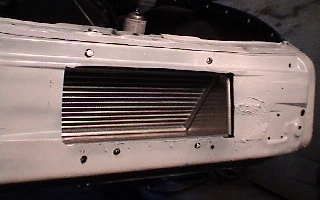

i originally had a narrow body rsr front bumper on my 77 with the a fender mounted 28 tube cooler and a nose cooler mounted as far forward as possible. it worked good on the street but on the track i could still get the temps to 240. temps dropped fast on a cool down lap.
here is a picture of this setup with the bumper removed.
i then started my backdate project on the car and the early bumpers do not sit out nearly as far. the back of the cooler really needs to sit flush with the nose panel.
i had a air duct fabricated, ala rsr type, out of aluminum and rivited it in. clean, simple and great air flow. after this modification my temps on the track never got over 215
i think it is really worth the modification although as mentioned above in extended stopped traffic i do not get any air flow so those temps can rise but as soon as i get moving down they go.
