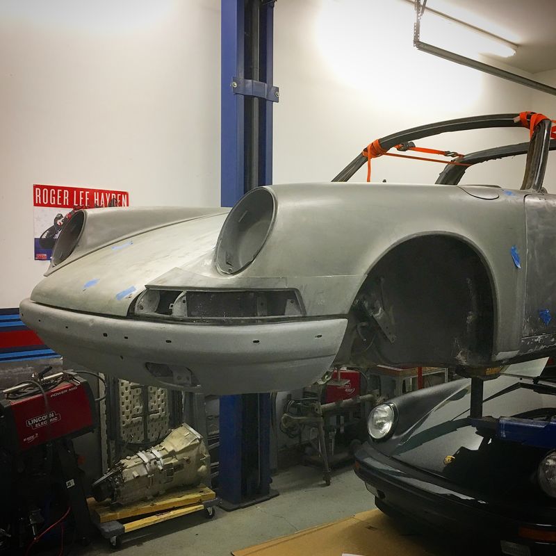

We had a 73.5 targa follow us home from craigslist last year, and we have time to work on her finally.
Originally Aubergine, she was bare metal repainted back in the late 80's to black. She's been off the road since the 90's, and luckily survived the 80's without being "upgraded".
The original 2.4 fired up with some work after we got her home, but decided to do a full rebuild. Case is off being inserted and inspected, heads being checked. Records showed a recent top end by a local Porsche mechanic.
This is when we brought her home.

Nice to find the factory color inside the car
We took most of the paint off by chemical.
Dash we need a restore
Next order of business is rocker repair
Braces made for while on the dolly.

Plan is going back 99% stock. Engine getting a few minor upgrades internally. May do some inserts in the seats. Original 15x6's are with the car, but have a set of 15x7's for fun.
This is the plan.

Priorities off and on. Back on priority.
Floors done, pan done, fixing front fenders now.

Had a change in status at the house, so have some extra time on my hands.
Finally got metal conditioner then epoxy on the targa tub
