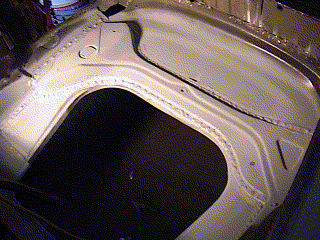

This is the repair I did to my car, I jigged the panels and took an excrutiating amount of measurements to locate the repair panels properly. I then punched holes about 1" o/c and plug welded the repair pieces. its not the prettiest but it is strong.
So many people judge a job by exactly how the finished results look, and less by how strong the weld may be. strong welds look good.. good welds look strong....... whats does a strong weld look like?
The inspection criteria for welds ALWAYS involves visual inspection. and for the most part pretty welds are acceptable. Undercut and overfill are obvious visually, porosity and crater cracking are also obvious.. arc strikes and other tell tales are obvious as well.... on stressed members they lead to local hardening and stress risers......
Mild steel sheet metal is very easy to weld, and kind of hard to screw up.The 911 was put together with spot welds.... in stressed areas they are more closely spaced....make sure your installer is at least replicating the amount of weld the factory used... but more importanly make sure they locate your suspension pick up points properly.
Im betting the repair panels are coated and galvinized. So just protect the welded areas with inorganic zinc. then top coat as needed
