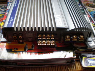

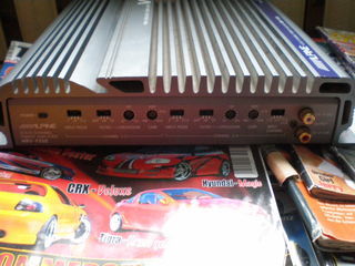

rwest,
Here I found some pics of the 4 channel amp, Alpine MRC F250
input, it has options for RCA and low level speaker wires.
And here is the pic of the output to another amp, RCA on the right, with all kind of adjustments.
I think I am ok with the connecting options. The thing I need to know now is if sound quality will degrade much by swapping only the head unit.

Simple answer/solution...
Hook the BOSS' 2 RCA outputs to the amp's input, bridge the f/r together, play something that has a large DB range. Now connect the BOSS' front speaker outputs using RCA adapters, bridging the same way. You might have to attenuate the BOSS' high (speaker drive) output level so as to not overdrive the alpine inputs.
Listen closely to the 2 configurations.
Unless you have a tin ear the loss in dynamic range, flat-topping of the high notes, using the speaker outputs will be VERY noticeable.

Generally, your low level or RCA outputs have a lot lower level of distortion, so when you take the speaker level outputs that have gone through the built in amp with a high level of distortion, about 10%, you end up amplifying that distortion to boot, so use the RCA outputs to your amps for the best sound.
I think you could pretty easily run power to the Boss unit and plug the RCAs into your amp and speaker set up to see how it sounds. The Alpine unit will be of higher quality, but given the noise floor and the music quality of a SD card, I doubt you'll easily notice a difference.
I can't tell from the picture, but it sure appears like the one amp has a crossover built in.
