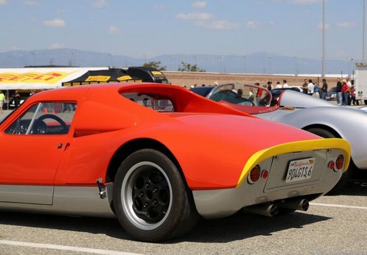

I like your Ronal wheels, would spray the inner part black with PlastiDip leaving the outer rim silver.

kach22i, funny you should say that, I got the black porsche wheel paint 3 weeks ago to do the wheel centers black, just what I was thinking, although after taking the wheel center caps off, the wheels are growing on me as they are, we will see

BTW-I like the wheels the silver color. Mine looked like that last year. This year they are completely different.

Posts: 54,017
FYI: This is what blacking out the just the center can do for homely phone dials.
BlackOut Rims
