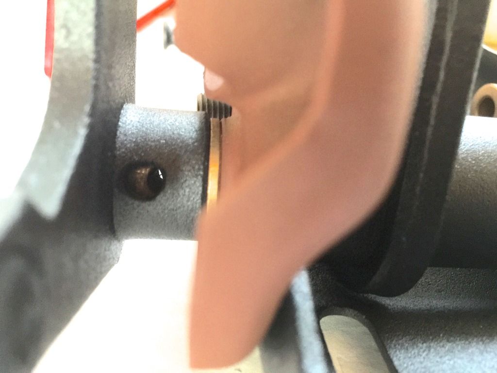

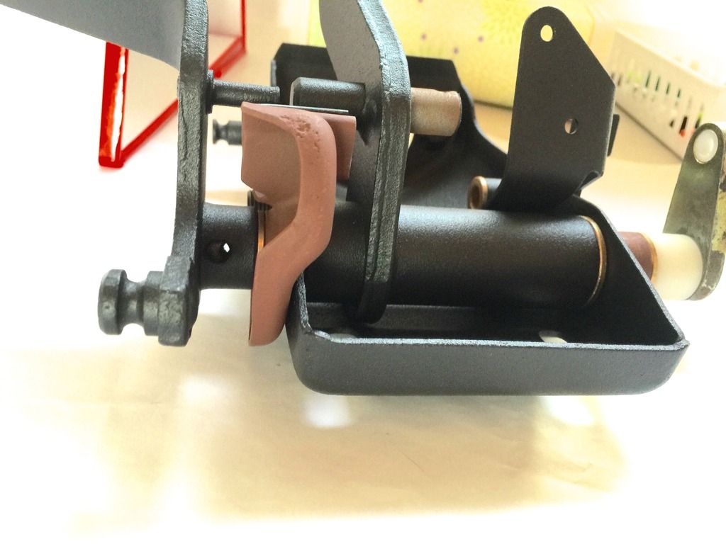

I am in the process of rebuilding the pedal cluster for my 1976 911S Targa. I believe that I have all of the necessary parts for the assembly. I was doing a test/dry fit and its looks like I might have a fitment issue. I'm hoping its a simple fix that one of the members will be able to easily diagnose. I have posted a few pictures.
It looks to me that the plastic bushing on the right might be thicker/wider than it should be which is causing the misalignment for the pin hole on the left.
Anyone have any thoughts or suggestions? My first thought was to shave down the plastic bushing/spacer until the holes align but figured I would check here before I make any modifications to the new parts.
Obviously the springs are not attached in the photo: again just a test fit.

Shave down the plastic spacer???

What Draco said. The spacer currently being supplied by Porsche is too long. After having this issue myself I sourced a bushing from another supplier and had the same problem. The correct bushing may be out there somewhere but not at Pelican or Stoddard.
Just shave a little at a time, let it cool and pop the melted plastic out of the center where it will accumulate.
Be cautious not to shave too much as you will end up with unwanted slop in the assembly.
FYI I have tried both ways and find it simpler to put on the spring before I press in the roll pin. Just keep the clutch arm hallway off the shaft until you spin it into place and clear the rubber bump stop.
Good luck!
Whit

You guys know that there were two bushings used and one is narrower than the other... right?

There are lots of different parts used over the years. I know of three or 4 clutch release shafts and at least 2 plastic bushings. Some combinations of these parts work better than others...
I don't have a part number handy for the narrower plastic bushing, so you'll have to do a little research on your own. Or, just trim the one you have in a lathe.
JR

You are correct JR. Pedal clusters for the early cars are 65-67, 68-72, 73-76, 77-78. With a couple funny crossovers thrown in transition years just to foul us up 50 years later
But as I stated the one being supplied by Porsche for the 73-76 clusters is too long. It is the bushing for a later production set. If you can find the shorter bushing I would love to know where.
