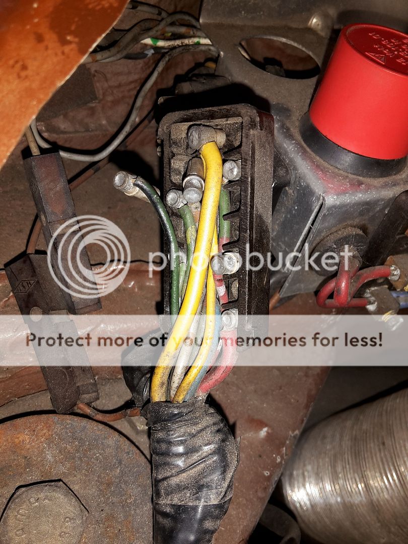

Ok I found that the yellow thick wire of this connector was loose...
Don't ask me why.
But the cap of the connector was of...
I removed the connector and offcourse 6 other wires came loose...
Which goes where? ??
Oops

Ok forget the last post...
Google saved that for me ☺

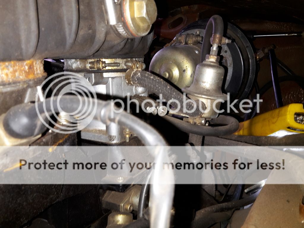

Ok since vacuum is also very important.
The low small hose from this tank.
The other side was loose in my engine bay..
I found it driver side against the firewall.
But where does it connects to?

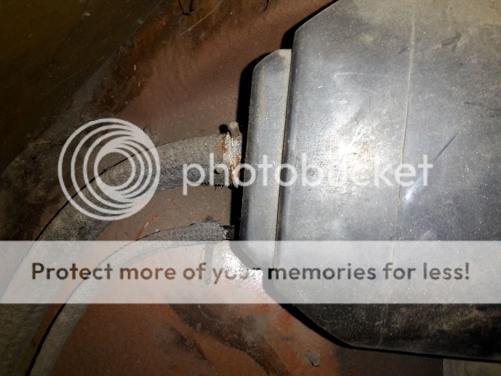

Also found these 2 hoses blocked off...
Won't be THE problem.
Since engine worked ok years ago...
Old 08-01-2015, 11:34 AM
