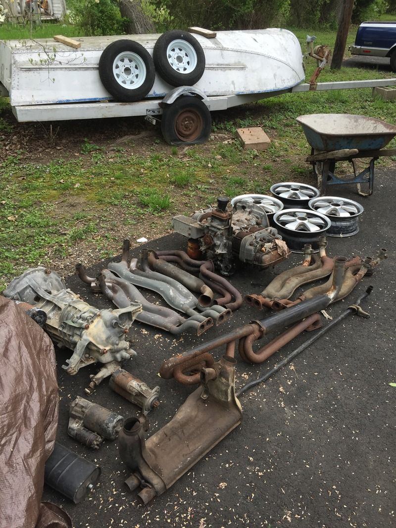

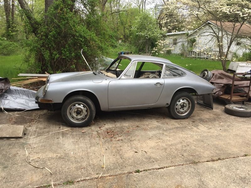

Figured I would start an official build thread on my 67 912. Hopefully when finished it will be a nasty bastard of a car. It will be painted what I hope is an interesting 50's VW color and basically just be loud and quick and NASTY!
So long story short, I knew about this car for a long time, some years ago I bought a 356 off the owner and at that time 912's were not really worth much and I was only interested in his 356. A number of years later, probably 12 years or so, I decided to stop by and see if he still had the car and would sell it. Timing is life is everything, apparently the owner was moving within the next 10 days and he was getting ready to list the car for sale.
I bought the car and a number of extra parts (2 motors, 356 parts) and he made me buy his 914 because he wanted it gone. Luckily on the drive back I sold the 914 to the tow truck owners son (wife would freak with all these cars and parts all over).
I crawled around the car the best I could and it seemed solid. Owner said he replaced the floors, front suspension pan, etc. Well upon stripping the car I found what you see in the below pics. Through the help of Pelican I found Matt (theFixer) and we have just begun repairing the car. This may be a bit of a slow build but we will update this every time we make some progress.

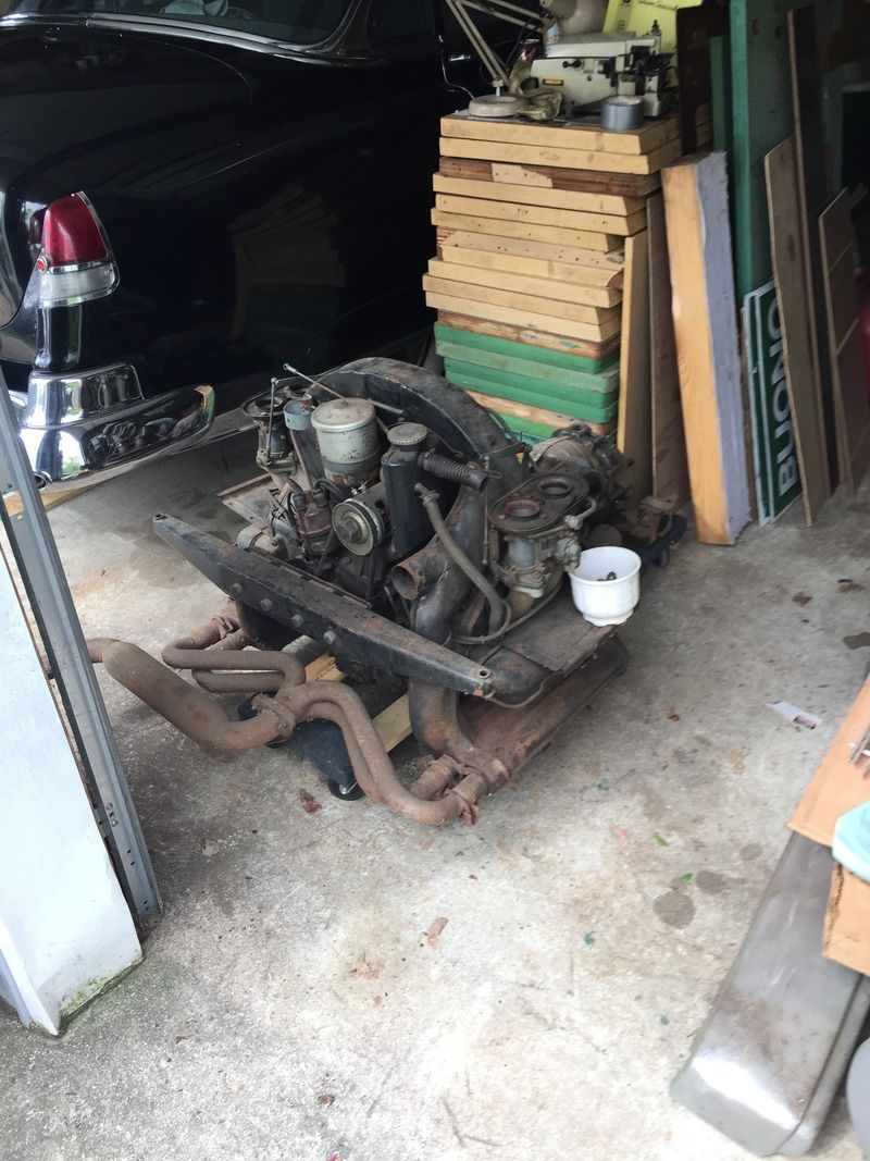

The car came with the matching numbers 912 motor and a 71 911t motor and trans. Not sure what I will use for a motor yet, but it will get a 911 motor.
1995 993 Iris Blue
1962 356 T6 B

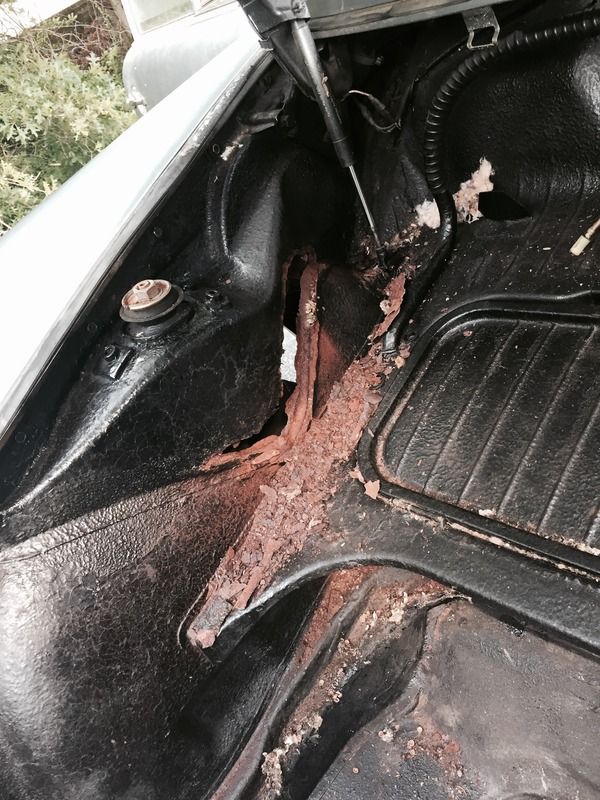

While stripping the car I found this mess and thankfully Matt (theFixer) came to the rescue. I will let him post more pics of what he found and what he has done to repair the car so far.
1995 993 Iris Blue
1962 356 T6 B

We have repaired the passenger side strut tower so far. Steve picked up a good used strut tower section on the West Coast that was just enough to remove the rusty area caused by a large mouse nest. This opened strut cavity was prepped, weld through primed and repaired. We'll also spray WURTH's Cavity Wax into this strut cavity
via the demister duct hose opening.
We have 8 hours time in at this point. I noted that replacement outer rocker panels have been installed incorrectly which is causing the doors to be misalligned. Taillight boxes were made out of heavy ga sheet metal and need removal and replacement. The floor pan replacement is OK but needs cosmetic clean up of the welds and seam sealing. We spent 2.5 hours today and started removing the thick paint with Aircraft Stripper.. Original color guess anyone?
