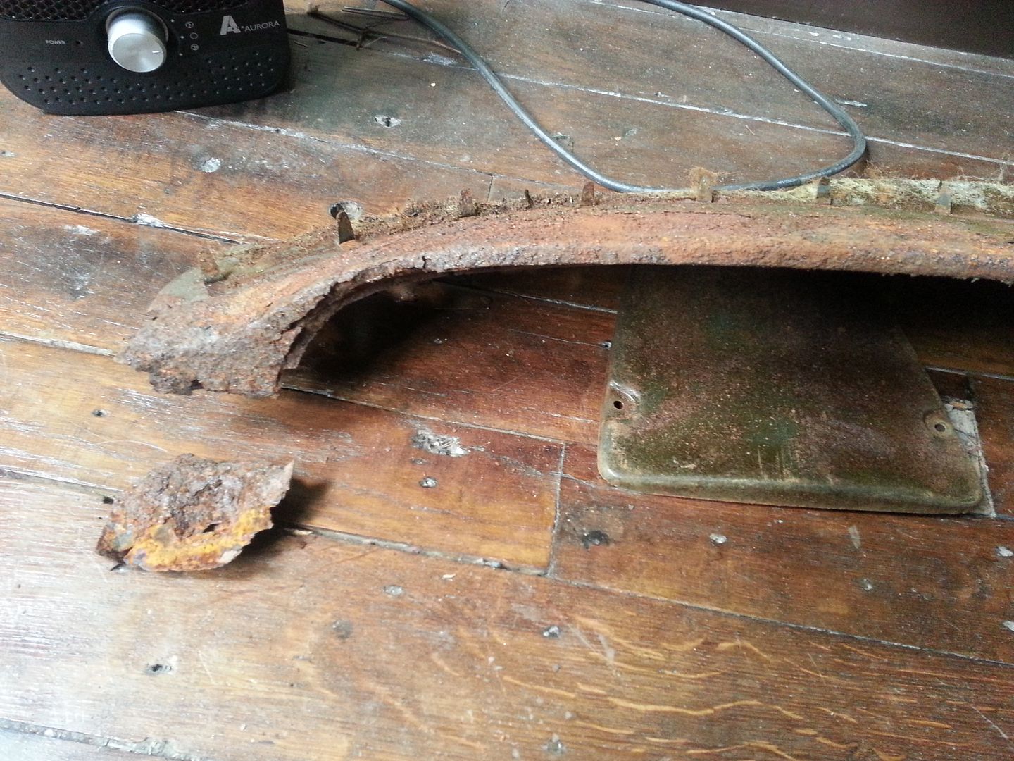

Is it possible to use a 69-75 dashboard assembly on an earler 64-68 car ? or does anything need modifying to adapt it ?

Just pushing this back up, does anyone know if the dash is plug and play/identical fit between a first and second generation 911 ?

The 67 is one piece dash bord with 3 vents 68 is two pièces dash with 3 vents 69+ is one pièces with 2 vents.

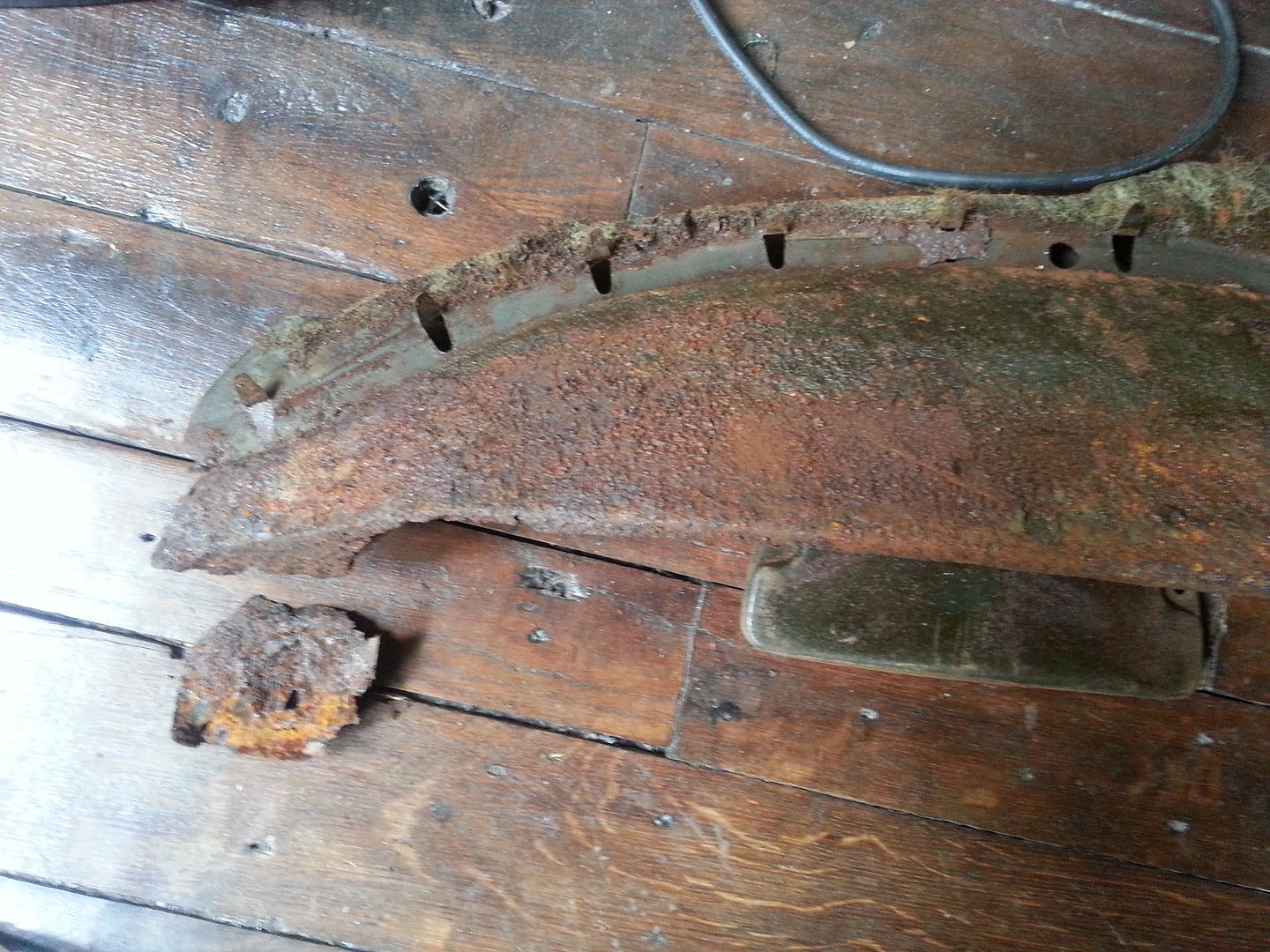

Any chance the overall shape is the same ? meaning I could adapt the vents area of my dash to a later dash ?
Just asking because this is the condition of my 67 dash, and I'm thinking since I don't seem to be able to find a correct year par at all, but a 69-70s one is available for just about reasonable money, it would probably be less work adapting the vent area from 2 to 3, than rebuild the dash I have ?
hard to assess when you don't have all the parts at hand to compare.

Hum not much left.

Nope, not much indeed.
