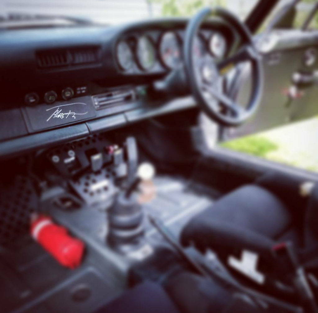

Radio delete panel fitment issue
Bought this here on our host's site, it doesnt fit flush within the recessed area like I imagined it would when I purchased it. Also is loose and tends to shift downwards on one side when driving. Anyone make a panel that fit's the hole properly and is recessed instead of sitting atop the surround loosely?

I used a dremal and made it fit the inside edging, and drilled two holes in the tabs and cable tied it in from the back.

es is right....a little time with sandpaper on a flat surface, and slight radius on the corners, to get the panel to fit the opening.
For a tighter fit, I used heat on the tabs to bend them to be a little more aggressive in their grip of the dash cut-out.
