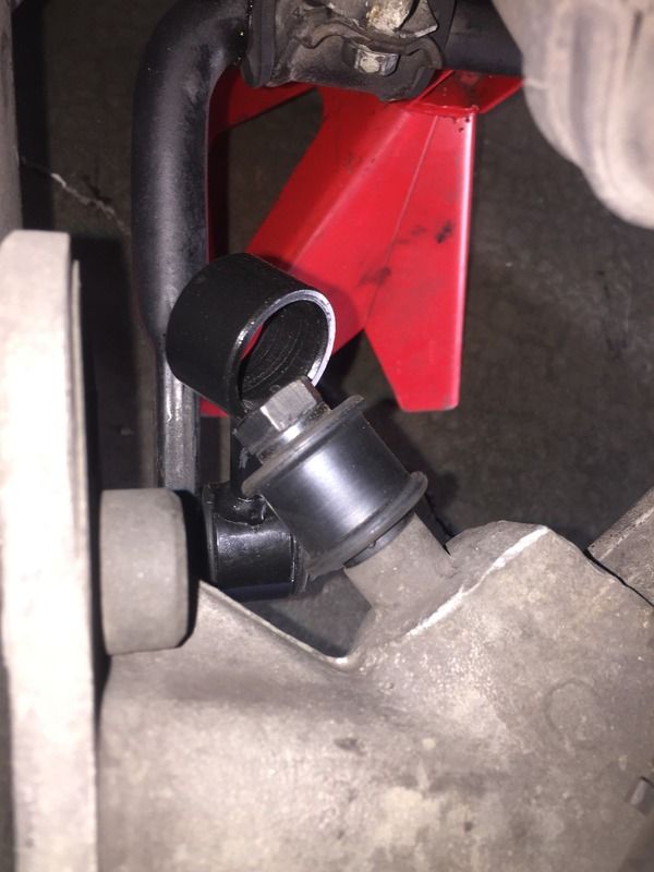

So I got the Lemforder links, WHAT AN EXTREME POS!
Driver-side popped out at top, 4 days later, normal street use:
I found some Older Designed links will give them a try:
Not really wanting to add cupped washers, No one should not have to do this if it was made correctly, no? How does a thin piece of rubber lip suppose to hold those suckers in? What a Turkey, made in Turkey.
