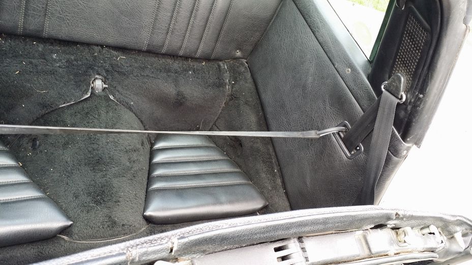

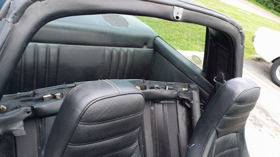

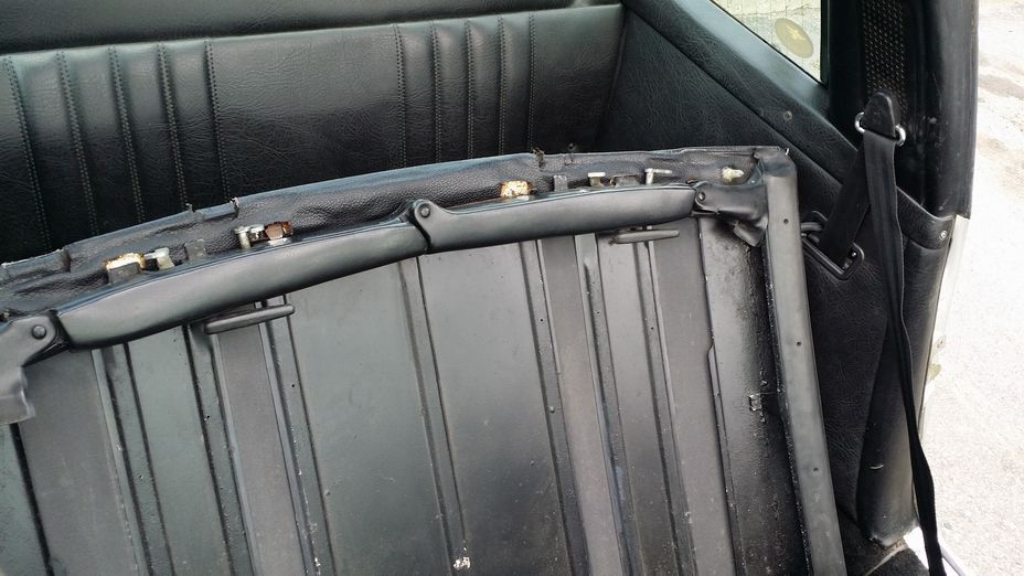

I recently took out my rear seat backs, this caused the Targa top when in storage behind the front seats to tilt more into the rear seating well.
I had the problem of scuffing before from the top's corners which are sort of sharp, but now with no rear deck it was even more alarming looking, so I splurged on a $2.00 bungee (31 inches long) from the local NAPA store.
My first attempt was rather ill fated, could not retract the front seat belts.

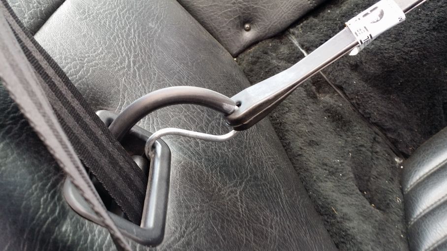

The below works, but now I'm starting to worry that over time it could pull the interior out, did what I could to protect things with a small rubber hose attached to the "S" hook.
If anyone else has done this, and lived to regret it, please let me know ASAP.

Careful with the plastic seat belt surrounds they can be very brittle.

If your top is resting on the transmission tunnel, it will definitely deform your top in time.

I agree. Setting it down on the front edge or back edge will cause future problems.
