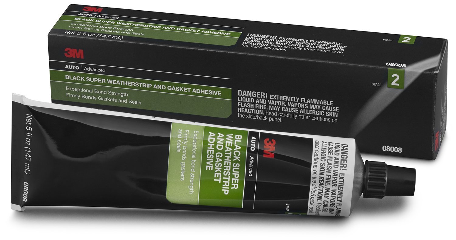

I was pretty surprised by how clean mine looked. Note that there is a clay-like material that seals the back panel on the housing to protect it against the elements. A lot of that material crumbled off just by me touching it. When I put it all back together I sealed the housing with 3M 08008 Black Super Weatherstrip and Gasket Adhesive.
