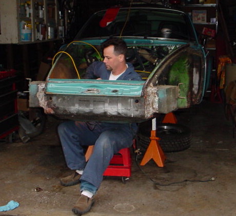

The plan was to completely update the suspension and brakes, install some safety equipment, shoot a quick coat of paint, then get out on the track. Not concourse stuff, just the basics.
I removed the front suspension for a quick cleanup and the upgrades. The wheel wells had been sprayed with undercoating by the PO, which I hate. I figured as long as I had the suspension out, and I was going to repaint anyway, I might as well clean up the wheel wells and spray them now. Simple enough.
Oh, then there was a nagging rust spot in the wheel well. Since I was going to paint the wells, I had to weld in a repair first. Got that done.
Then I decided that if I was going to repaint the wells, I might as well pull the fenders and do it right. And gee, while you're at it you might as well spray the trunk too.
That means pulling the tank. With the tank out I might just as well do that center fill cap through the hood I've been scheming.
One thing leads to another. and I find myself here:
Scraping out rust proofing material and fiberglass crap put in be a well intended, but misguided, PO. As I scrapped and worked the heat gun I couldn't help but think about how little time it took to put that crap on there, and how long it is taking me to fix the damage.
It seems some rust in the corners had been "fixed" by slapping quick fiberglass patches on then gooping on thick rustproof material to hide the patch.
Now it's all gone, and I'll be welding in proper patches.

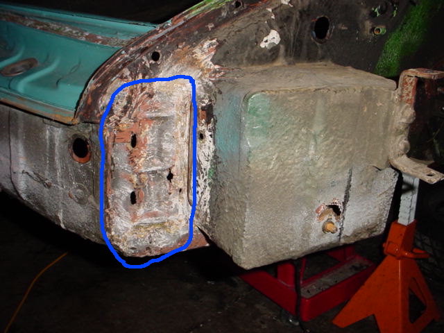

Which leads me to a question. Where can I buy pre-formed patch panels for the section highlighted here:
I can form my own, but I'd rather just buy properly shaped pieces.

Actually there isn't much rust. The brown stuff you see in the picture is a brown primer.
The rust is really just a couple of spots in the corner. The two holes in the front are for bolts to hold the bumper.
The rear hole is, well it's a hole! From rust.
As I've been stripping things down I have found some old rust repair that I was not aware of. However, except for the hack job in these corners, it has all been done very well.
Finding a clean section from a wrecked car is unlikely. This section is notorious for rust. I'll fab my own if I can't find a supplier of new patch panels. I looked here:
http://www.restoration-design.com/index1.html
They make a lot of this stuff, but don't list the section I need.

Wayne, I didn't realize you had patch panels. But I don't see the one I need. Looks like the hammer and tin snips will get a workout.

Hey Chuck, Looks like your doing it right! I was wondering about these patches...and what it is you mean. I've never done this.
Are you going to cut out the bad areas and fab up pieces to fill the voids and weld in place or are you going to use doublers on the inside? or outside?

Jorge,
Yes, I'll be cutting away any cancer and welding in fresh metal.

I have been repairing the same area on my 71 project. AFAIK, there are no panels available. The front bumper mount is a extra thick area attached to the inner fender well in front of the batt, box. That area is part of the entire fender well stamping. The easiest thing is to fab your own panel to replace any cut out rust. flat sheet stock should work well in that area. watch out for that curve outward just past the mounting holes for the bumper.
