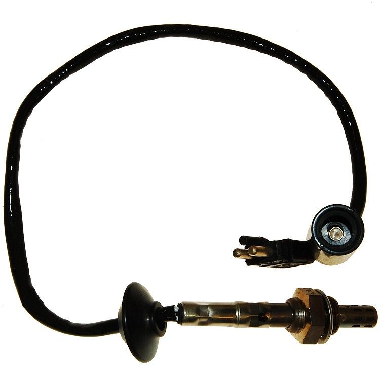

Has anyone tried this sensor? Not the universal but OEM connector one.
1985 Porsche 911 Carrera Targa - Emissions Equipment - Page 1
I think Pelican has the wrong diagram
Here is the pic I found on the net, looks like the correct connectors for 3.2 84-85
Supposed to be NTK ( NGK ) innerds.
Heck, it is even more expensive than BOSCH.
I have lost faith with Bosch products and want to try something new.
TIA,

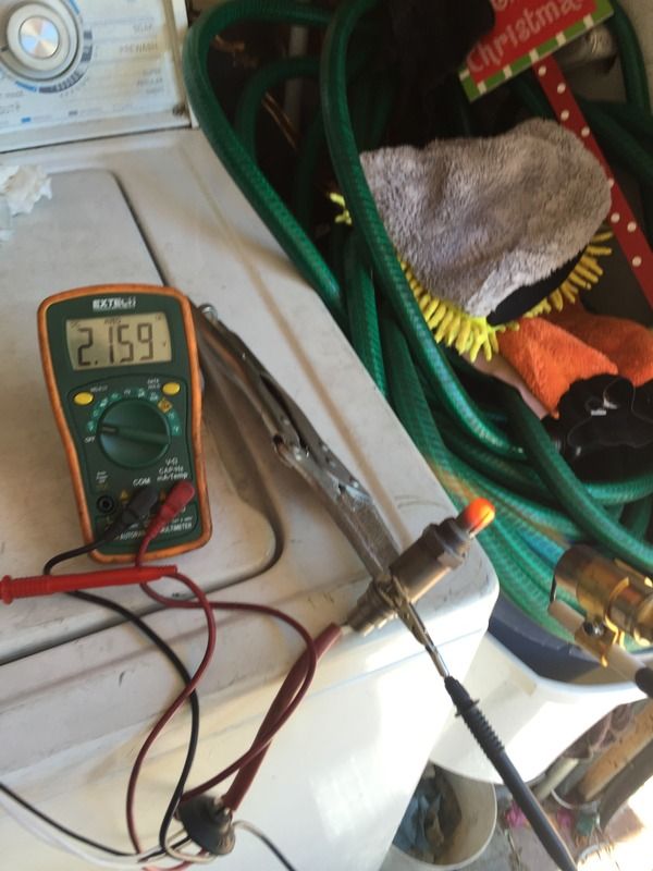

My BOSCH O2S is not locking at 14.7 or 1.00 volt. It is reading my car is rich and locking at 15.4-5 but my AFR verified by my ML2 shows 14.7s until I connect the O2S then locks it lean. Very strange.
Under load it fights to get to 14.7, closer to 14.9
Measured the O2S at 14.7, shows 0.93 volts, that can not be right. Producing High HC's at over 90PPM.

So I decided to test the BOSCH sensor:
4th one that failed within 3 years. Returning to Pelicans so they can send it back to POS Bosch in Spain. Grathiath :P

Hi Jim...It appears to me that the original Bosch equipment is far more superior than their replacement parts. I'm sure that any manufacture who uses Bosch would dump them if they were as bad their aftermarket items are proving to be.
I would suggest that you pickup a NTK Oxy sensor as they have a great reputation. The same goes for NGK plugs...That's what I use, and from now on in, it will be Beru distributor caps...As most already know, not all German products are 'better than'...e.g. A Blaaaajunkt vs say a Pioneer.
