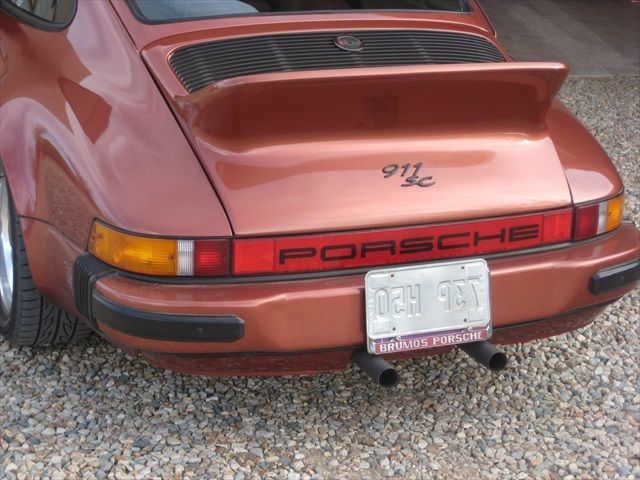

Reiver
Reiver's Avatar
Join Date: Nov 2011
Posts: 57,624
Ice,
The banana Dansk 2/1 is really a nice unit and I used one for years on my SSI's. The base model (prop tuned for a stock motor) comes in a battleship gray.....however this, once hot' comes off easily to expose a shiny steel underneath. Clearcoat with a heat resistant paint or get a can of paint for an iron wood stove (Stovebright) and apply it when the muffler is warm. They have some really nice deep grays that hold up extremely well...and other colors if you are so inclined.
I eventually succumbed to 'fashion' and bought a Dansk pea shooter 2 out with the smaller outlets.
I did not want to ruin my mid range response so measured the outlet on the one out (total square inches/area) and replicated that on the 2 out by placing a small baffle in one of the exit pipes.
This had the effect of keeping my mid range from being mushy and totally eliminating any drone.
The peas shooter is quiet unless you wind it out...and, honestly, I did if for the visual.[IMG][/IMG]
