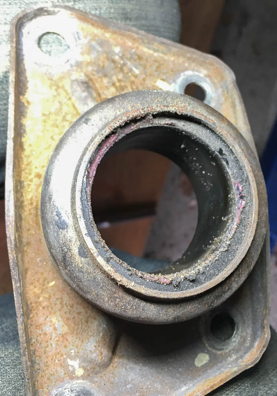

Well. I dunno what this thing is, but it doesn't seem like its difficult for dirt to get personal with it. Maybe it got there after I removed it, though. It doesn't feel like rubber or metal.
Does the weight of the car ride on this, or should I take the spring plate off to see what's behind?

Standard black polyeurethane bushings. Like the ones In my first picture above. The inside will match. These are the cheap ones that squeak (your main complaint as to why you are considering changing them out)
Upgrading to rubber from ER would be easy as you don't have to burn off the original rubber ones, as the current ones have been installed recently. The red you see is the high temp /pressure grease.
You are looking at a $300 job at least to swap them out if you include alignment.
I'd decide whether the noise is worth it at this point. The one pictured is newish and not out of round, so it's doing its job.

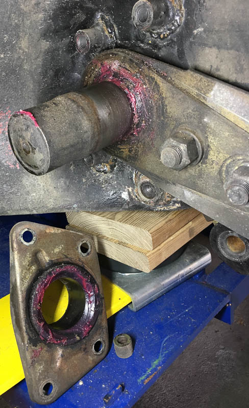

Indeed, upon closer inspection, these are a set of der Weltmeister 004 poly-graphite bushings. These squeaks are currently the most annoying aspect of the car, so they've got to go. I'm gonna order some standard rubber suckers and attempt the job myself, then have a shop do an alignment.
If I screw it up, it'll be obvious and correctable, so...Time to research this job. I just bought some DIY zinc-plating stuff, so maybe this is a good time to give it a shot.
I also have a set of Smart Racing adjustable sway bars that are too stiff. I like the adjustability, but I might try and get a softer bar in there, if they still make 'em...

Looks like those poly bushings were lubed with a typical red synthetic bearing grease. They may not have squeaked as soon, if typical poly bushing grease was used. The stuff I used was from Energy Suspension and it's a clear-ish sticky paste. WAY stickier than most greases you'll find.
Nonetheless I agree it's a good idea to ditch those polygraphite bushings and replace with rubber. I had really good results with using "Neatrix" replacement rubber bushings.
Be sure to clean the spring plate tube VERY well with solvent to clean up the grease. Then you'll adhere the new rubber bushings with super glue (cyanocrylate). Then use a lubricant like dish soap or silicone spray to allow you to install the spring plate. You need the lubricant because if you install it dry, you just can't get the rubber bushing to push into the chassis and the retaining bracket without a LOT of effort.
It's also wise to use some longer M10x1.5 screws to pull the spring plate into place. The original screws are just a wee bit too short to effectively pull the plate in place. You really have to hammer on the plate and bracket pretty hard with a heavy rubber mallet or dead blow hammer to knock it in, if you're trying to use the original length screws. Better to just use longer screws (and some antiseize paste on the threads) to make easier work of pressing the spring plate home. Once you get the assembly seated pretty close, you can switch back to the original shorter screws.

I've got the same bushings and same problem
I've got a bare interior and believe it or not, the squeak is louder than the engine and is in hearing damage territory
I see regular spikes into the 110+ db readings with my meter.
