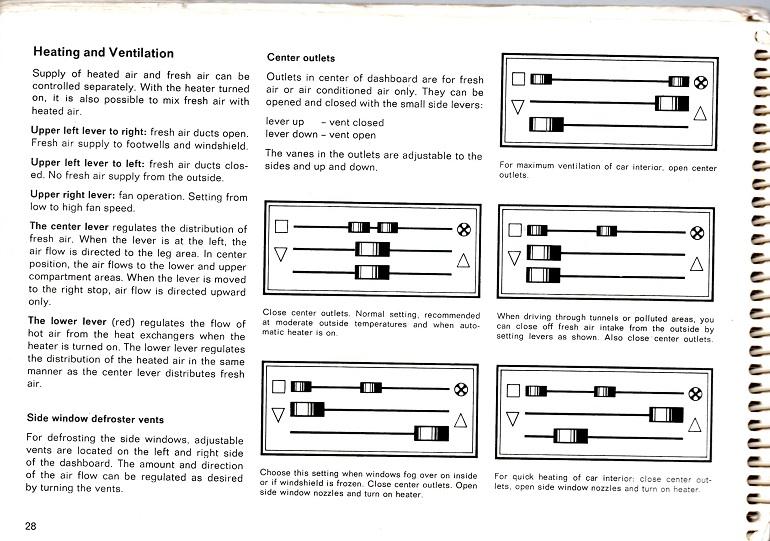

this might help??
Ivan
Old 12-04-2018, 10:31 AM
Tori's Avatar
Join Date: Jul 2016
Location: Pismo Beach, CA.
Posts: 657
Thanks, that's more extensive than what is in my owners manual. I like how it gives examples too.

ok cool;-) i should have said ..the pages are from top 1987 2nd from 1985 and 1978 owners manuals..
