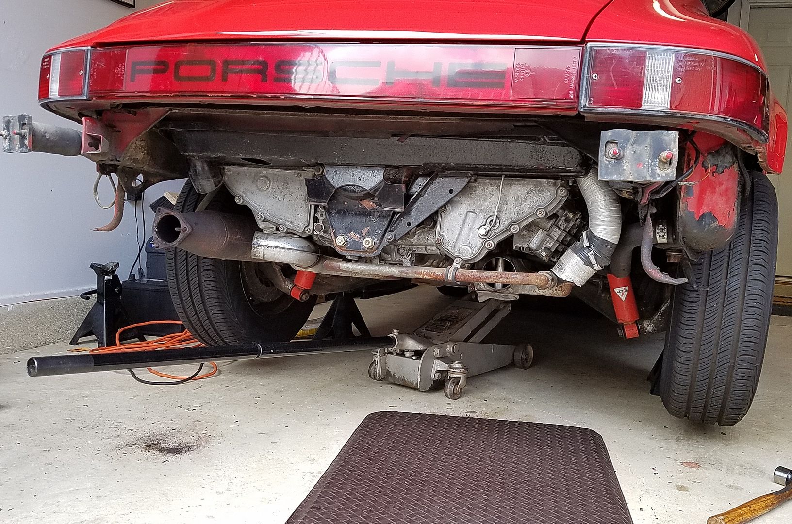

I just installed SSI heat exchangers on my 82 engine. I'm keeping the heater blower so I used a flexible hose from the bottom rear tin tube to the left SSI heater tube inlet. It's a tight fit.

For some strange reason, lately I haven't been able to upload pics to Photobucket from my Android so I cannot share a few from yesterday.
Here is what I started with.
