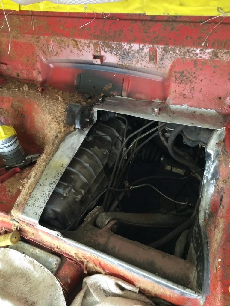

While we address the rust issue, I have been researching, going back and forth of what level of sound deadening I want to take this, while still keeping the weight in check.
Once I've prepped the surface from the old sound deadening and have the new pan primed and paint my plan is to follow nineballs method of a 40-50% coverage of a butyl based Dynamat. But then I am torn as to whether to follow it with some mass-load-vinyl or closed cell foam, to reduce the engine and road noise, before laying carpet.
But side note: Here's a photo I snapped yesterday while checking up on the progress. Rusty pan out, new pan on its way in!
