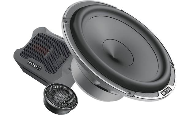

I've posted my stealth solution here before for my '79 Turbo, where the appearance of originality is important:
1. Blaupunkt/Porsche CR in dash. Stock install, but speaker line-outs go to:
2. JBL GTR 104 (4x100w, with built-in bluetooth, also accepts line-in and speaker-level inputs), mounted under driver's seat, going into:
3. Hertz MPX 6.5 components in the doors (mounted with apexpaddles.com spacers), and:
4. Alpine PWE S8 compact powered subwoofer under the passenger seat.
I can play the radio or cassettes (yay!) from the head unit, but with far superior sound due to the speaker and amp upgrades AND also stream music/podcasts/radio from my phone. The only visible change from stock are the speakers in the doors.

https://www.crutchfield.com/p_301MPK1653/Hertz-MPK-165-3-PRO.html
