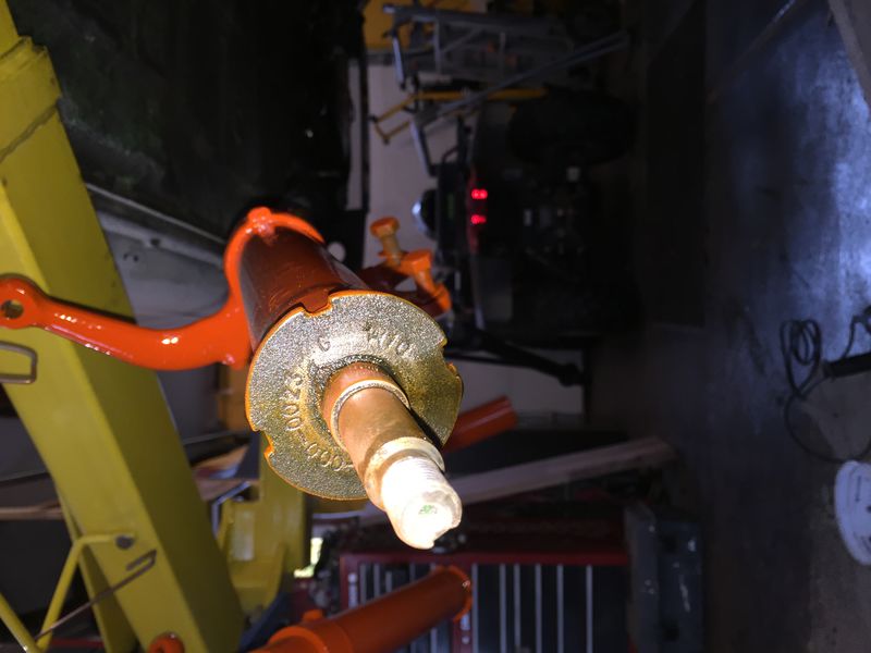

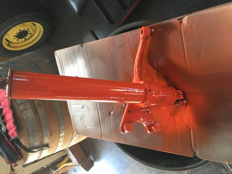

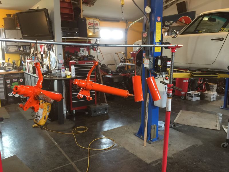

I am rebuilding my front suspension, the part numbers on the struts are hard to read somimm it sure what to buy for inserts? I have 19mm front torsion bars and a 22mm sway bar, anyone have recos? I have koni classics in the rear, not sure if I should keep Konis up front too?

Better pictures of the struts

Look like Boges. What year car?
What brakes? 3 inch bolt spacing?
If you pull out the inserts you have it will be more obvious.
Now that they are cleaned up, you should be able to see a stamp somewhere.
You should be able to get Koni classics that will fit.

3" spacing M calipers now, I'm looking for 2" Alfa brembos
