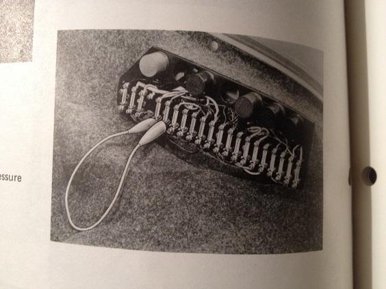

85 3.2 no start
hey all last year my 85 wouldn't start. it turned out to be the the reference sensors. so now I have the same problem. it cranks over but no start, the tach moes a little bit, I switched dme relays, but nothing. I have spark, I checked it. I pulled a plug and wire grounded it and cranked it over, I sprayed starter fluid in it, it catches a little bit. so it seems like a fuel problem. I turned the key on, and I cant hear the fuel pump run. is there a way to check to see if the fuel pump is bad? it sounds like it has to be the fuel pump.
thanks
tony

Hi Tony
to check you fuel pump use a little jumper wire and cross you no 6 and 3-5 fuses at your front fuse box .direction from windshield..No ignition on needed.

The fuel pump doesn't run on key on. As mentioned above, install a jumper to make sure you have a functioning fuel pump. It wouldn't hurt to put a pressure gauge back at the nut on the fuel rail as well.

ok, so I finally checked my fuel pump by jumping the number 16 and 17 fuses. all I had was kind of like a clunk sound. seems like the fuel pump isn't running. so does this mean it is the fuel pump???

Let's put is this way. Without fuel pressure the car will not run. To develop fuel pressure the pump needs to run and be in good working order (amongst other things). If you got to the right fuses and what you heard was a bad pump trying to spin then: "yes it is the pump"
