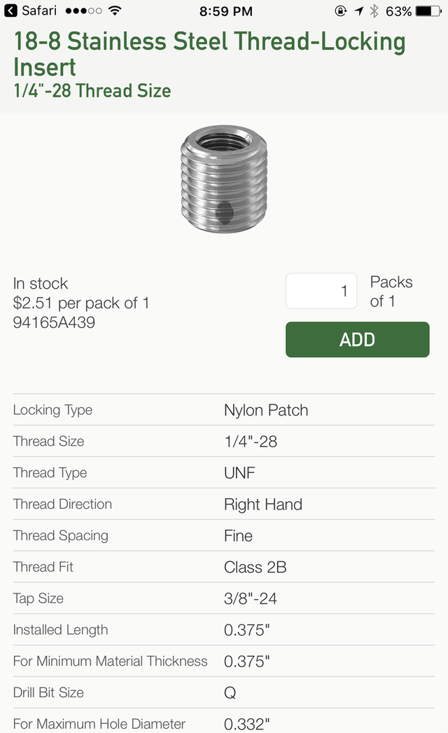

I bought a rennshift and wanted the wevo sl shift knob, so I figured out how to make it work for anyone wanting to do the same.
Bought a 3/8"-24 threaded insert with the center 1/4"-28, bought a 1.25" long 1/4"-28 cap screw in black and with the insert it works great!

Very cool, I love that knob, where did you get the insert?

I got it at https://www.mcmaster.com, bought the bolt local.
