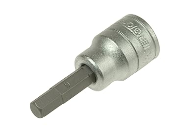

I'm guessing I just need to put an allen wrench on the CV joint bolts??
They aren't budging and I've used a hammer against the allen wrench... but I don't want to strip it down trying to get these off.
Anyone have some suggestions?? I'm guessing it is still counter clockwise to take them off??
Should I hit each bolt with some PB blaster??
What's the trick to get these axles off the transmission?
(This is a the last step I need to do before dropping my engine and trans)

They're simple socket head cap screws, should be straightforward removal. I strip a bolt head every once in a while, but usually can get them out with a pair of vice grips on the outside as a last resort.

Do you have a 6mm hex that you can use a ratchet on? Works like 10x better than a L-shaped allen wrench. (I think it's 6mm...)
Oh and set the e-brake to stop the wheels from spinning.

Clean out the cap heads on those bolts real good. It will help you find good purchase and help avoid stripping. Use the ratchet.

Use the socket Allen wrench like Matt suggested. You can put a lot more leverage on those as required.
As Tony said, get a pick or something to make sure that any crud inside the Allen head of the fastener is gone. It's gotta be super clean to ensure your Allen tool sits nice and tight against the bottom. With that thought in mind, it probably wouldn't hurt to tap your Allen socket in a bit with a hammer before turning to make sure the tool is seated firmly in the bolt.

Get a good set of allen head sockets. They'll be your best friend when it comes to removing the axle shaft bolts.

Not sure why people are suggesting breaking the hub nut loose? The axle shaft should drop down once you take the allen bolts off the back side of the hub and off of the transmission flange.
If you're buying an allen head socket, get a hardened impact style. I rounded one when trying to loosen one of mine. I also found it helpful to put a block of wood under the tire to help secure it while breaking the bolts loose. A bit of penetrating oil wouldn't hurt as well.

I use a 3/8" drive pneumatic impact with the aforementioned hex "socket". A battery powered will work too.

On other thing to note, if you can buy the longer version of that allen socket, get it and if you have an air impact along with an impact swivel you can lightly "bounce" the bolts with the impact. You just want to be careful you don't break one off in the axle or transmission flange.
What I did with mine when removing was rotate the wheel so I had easier access than trying to work my way around the axle.

Maybe clean and PB the exposed end of the bolts and take a wire brush to it.
With the wheel off I found if I used multiple extensions the impact gets absorbed and nothing happens. Using a long pipe did the trick on my 86.
Clean out the holes and tap the allen in nice and snug.

Don't hammer. Use additional leverage as others have said.
Check that you have 6 point allen bolts, many cars came with a 12 point.
Please take your time!!
