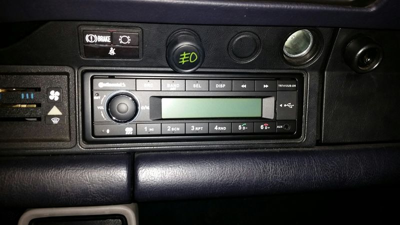

I’m finishing up an install of a TR7412UB-OR in my 911SC. Matches the interior very well, orange lighting, and Bluetooth, USB, and aux jack. $199 shipped, sounds good and easy install.

I have the Continental TR7412UB-OR as well. You really can't find another radio that fits better aesthetically in our cars.
However--they are bare-bones. No pre-amp outputs. This means they require some finagling if you want to hook them up to an amp.

I have the Conti TR7412 in my 930 and it fits the look of the dash quite well. It has Bluetooth and a usb port, which you may or may not use, but I like. The biggest downside for me was that there are no RCA outs. It is all line level outs to the speakers, so if you are running an amp, you need a converter to RCA or an amp that accepts line level inputs. I used a converter, but for premium sound quality, it cant be ideal. For my usage, it works fine for me though.
Here it is installed.
