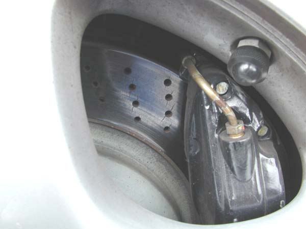

Thinking About Drilled Rotors?
Thinking about getting drilled rotors for your daily driver?
Think again.
http://www.ws6.com/cryo.htm
That doesn't look safe...........
Even the cryo-treated rotors are garbage. And not all that much abuse to them either.
I guess if the rotors aren't those with cast holes, why even bother if they're going to fail like these?
Granted, they're domestic rotors. I believe the brand are Baer racing discs.

This doesn't happen with a factory rotor. Who knows what process the aftermarket companies use to drill the holes.

There's a diff between rotors with drilled holes and rotors with cast holes. The stock Porsche rotors-with-holes are cast that way. Some places drill them for max bling, but these are known to crack.
I'd have to see more evidence than one set of bling-drilled rotors before I'd cough up $100 to have mine stuck in the freezer. I'm sure it can't harm them, but it does appear to be a drain on the wallet.

Interesting. This guy is all happy with cryo treating because he got 15k street miles instead of 4k street miles on a set of rotors.
Should we tell him that rotors should last 100k miles on the street?
I'm not sure if cryo works, but I do know a sample size of 1 is not significant. Both of the rotors shown are way past the point of safe operation.
FYI, I've even had solid surface factory discs develop cracks.

Yeah is does, just not as fast.

I agree that one sample is not a good way to judge the results of these rotors. But, you must agree that either 4,000 or 19,000 miles for a set of rotors is unacceptable. These rotors seem that they'd be a set of OE discs that were drilled. Just pure speculation on my part.
I do recall it being said many times that ALL perforated discs crack. Cast or not, it's just a matter of time. "Nots" just do it faster.
Hey, I know the NASCAR boys use the perforated discs at least once per year. The dreaded road course weekend.........
Wasn't the original purpose of opening up the faces of the disc to not only clean the pad of gases and pad material, but to evacuate water as well?

I do not undestand why the rotors in question were both drilled AND slotted.
(KTL provide the following link)
Everything I have read on these techniques, one is similiar in function as the other. Why do both? I would think that doing both would compromise the structural integrity of the rotor.

Any rotor will crack if abused enough. The factory w/ cast holes is just a little tougher than the drilled in this regard. The only 911 to use drilled rotors was the 911SC/RS which used the 930 rotors. There were no factory drilled 282.5x20 or 24. There are factory drilled 304x32, 309x28, 322x32, 322x28, 299x28 and 299x24 used on various 930, 965 and 993 models. Some were 2 piece some 1 piece. In general the newer ones are not useable on the older cars due to offset problems. The only exceptions are the 2 piece which can discard the newer o/s hats and replace them w/ zero o/s hats.

my understanding is all drilled/cast rotors will crack, just the cast last longer.
I think the escaping gases thing is pretty much a crock these days.
The only benefits that I see are decreased unsprung and rotational mass and increased surface area which is better for cooling. Race teams can use them because they inspect/replace their rotors much more often than we do.
Of course the benefit of solid is increased mass for heatsink and increased lifetime/durability.

Modern pads do not need the escape route for outgassing as much as the older pads. Weight saving is is real but minor. Bottom line there is no compelling reason for drilling(I'll continue to use them any way), cryo is a crock. Good metalurgy is the #1 thing to buy, stick w/ Brembo, Zimmerman, Alcon and you will be happy.
