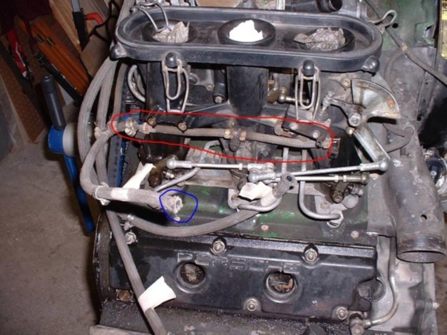

Hello To all,
Ive just joined your site, very good it is too.
I have a 1973 911. It takes me about 15 mins to get the damn thing started in the morning and its becoming a pain.
So i have searched the threads about the the cold start and i have learnt quite a bit.
The main BUT being the cold start system from inside the air box seems to be missing!
I have tested the tube on top of the pump and if you suply 12v's it pumps out plenty of fuel, with nowhere to go.
I would be very greatful if anyone could help me. I need a picture of the system inside the air box or i would like to purchase the system new or used.
Even some sound advice would be cool.
Many thanks in adavance.

Andrew, welcome to the board. Do you have an early or late '73? This determines if you have MFI or CIS fuel injection.

Tim only the 1" tube is part of the MFI system and it controls the enrichment circuit once the car is started. The bigger hose that goes to the air cleaner is merely part of the early attempt at pollution control. The cold start circuit on the late MFI consists of 2 fuel lines that run to each bank of throttle bodies, they in turn connect to individual "t" fittings at the base of each individual throttle body. These plastic "t" are impossible to obtain if they are missing.
Andrew, you probably have a cheap, but tedious fix. Before you go any farther, please, please, please, read everything in this tech article and you will be a happy MFI owner!

Old 02-19-2003, 01:24 PM
Friend of Warren
Join Date: Oct 2000
Location: Lincoln, NE
Posts: 16,506
Originally posted by AndrewWolfeUK
Ive had a look at the page its got lots of info on the MFi engine.
What i need is a picture of what i need to replace as i don't even know what any of it looks like.
Thanks again
Fortunately I took some pictures when I was working on my '72. In this pic what I circled in red are the cold start enrichment lines. What I circled in blue is the line that runs up to the fuel filter.
Kurt V

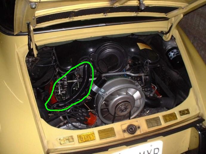

Old 02-19-2003, 01:31 PM
Friend of Warren
Join Date: Oct 2000
Posts: 16,506
What I circled in green here is the hot air hose that runs to the MFI thermostat:

Old 02-19-2003, 01:45 PM
Friend of Warren
Join Date: Oct 2000
Posts: 16,506
Andi, are we speaking two different languages here? As I previously stated THE LATE MFI SYSTEM SUCH AS YOURS DOES NOT HAVE A COLD START SYSTEM INSIDE THE AIR FILTER HOUSING. THE AIR FILTER HOUSING HAS NOTHING TO DO WITH THE COLD START SYSTEM ON YOUR CAR! IN FACT TAKING THE AIR FILTER HOUSING OFF YOUR CAR WILL HAVE ZERO EFFECT ON STARTING!
Go back and look at the pictures I posted. Do you have the cold fuel enrichment lines I circled in red? Are they and the line I circled in blue attached to anything? Do you have the hot air hose running to the MFI thermostat I circled in green? FORGET THE DAMN AIR FILTER HOUSING!

Old 02-19-2003, 01:55 PM
Join Date: Feb 2003
Location: England, Leeds
Posts: 209
O.K. Kirt,
I'm with you now, an English company had drilled the air box thing into my head about 6 months ago never been able to understand it, but i know why now.
There is no system like the one you circled in red.
The blue is also non existant.
The green circled bit is there and very much intacked.
Thanks again Kirt and Tim
Sorry its taken so long to begin to understand you!
submit signature here
Old 02-19-2003, 02:00 PM
Friend of Warren
Join Date: Oct 2000
Posts: 16,506
Now you know what your problem is. You have no cold start enrichment! Look at the fuel filter and the solenoid on top of it. I bet the fitting for the cold start line has been capped off. You will need to run the lines I have circled in the pictures. Look and see if you still have the "t" fittings on the throttle bodies. They are what connect the fuel lines to the throttle bodies that are circled in red. Are they there?
