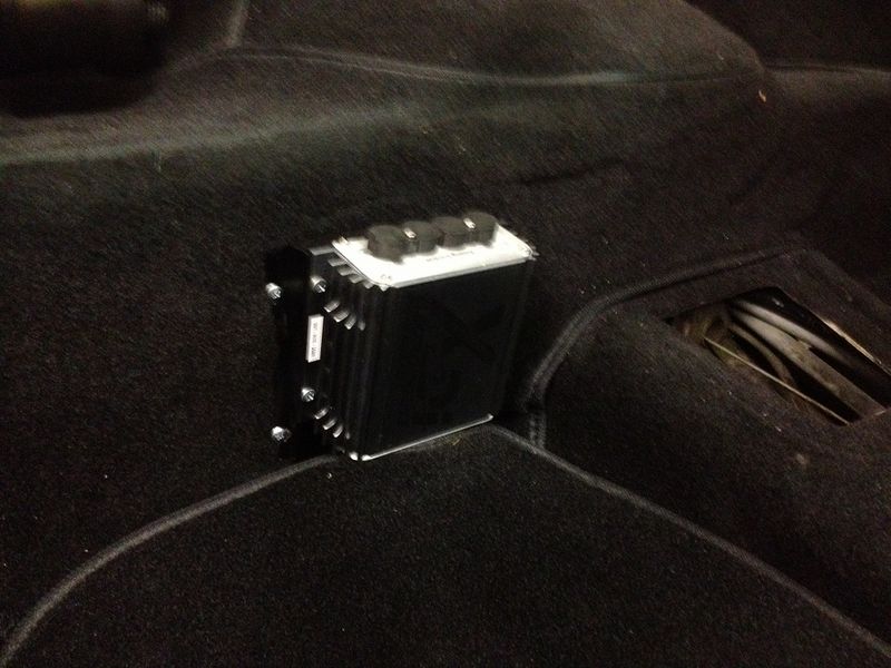

Pictures of my car............
Just found some pictures of the coil and control box as installed in my SC. Might give you some ideas!
Ignition coils on shelf, mounted on bracket made from steel angle.
Unit control box mounted inside the cabin.

Old 05-04-2018, 11:39 AM
Join Date: Feb 2017
Posts: 49
Thanks Fred - from all that I was reading and all that I could research, it did seem to me that you would be sending wires across the engine (the previous owner had a wire diagram but no manual etc). That is the main reason for my inquiry - the way he had the plug wires was like the first scenario. Very short, one coil to one cylinder top and bottom. So the coils were labeled like the wasted spark system, but "plumbed" like the first scenario. Very confusing - don't know if previous owner changed something, just did it wrong whatever. In addition, the coils lineup is different than you spoke about - you can see that in the picture. Thanks so much for all the time and help.
Old 05-04-2018, 11:48 AM
Join Date: Feb 2017
Posts: 49
Scott, are you running dual plug - would
you be able to shoot a picture of your setup - coils/control box and wires?
