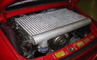

This intercooler was fabricated from a griffin core, and some 4' aluminum tube ( bandsawed on a bias) and some aluminum elbows sectioned to fit output of the turbo, and the3.2 intake

Rick the core was from Griffin, Ill have to look around for there phone # ( they are in SC or NC i think) The aluminum pipe was sourced locally, but Im sure you could get it from someplace like McMaster-Carr

PS Rick if you are using a 3.2 manifold the rubber boot WILL blow out at some point. Its best to get some exhaust tubing ( an elbow) of a like diameter as the 3.2 rubber elbow, and do some creative metal work to make it work.
