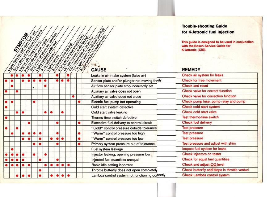

proporsche's Avatar
Join Date: Sep 2011
Location: Bohemia
Posts: 7,427
rxtrom..here is basic-table to start with....you can learn a lot form this....
Ivan
