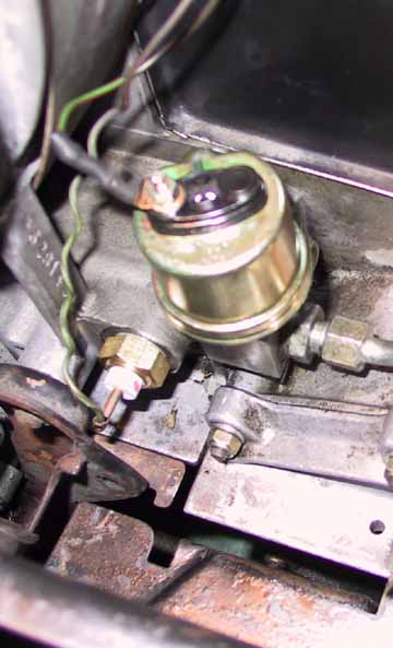

Keith, I was hoping you would have this worked out by now. But this is a picture of the sensors on my 3.0. It might give you an idea as to how to mount sensors. The oil pressure sensor is mounted on an adaptor which could be made to fit on any part of the pressurized system. The temp sensor is a bit tricky as it is longer than 1" (on my car) and screwed into the case. You might be able to tap into a spot that will allow the temp sensor to be screwed into, but this would probably be my resort.
If you can get matching gauge and sensors, it is possible to make it all work together.

Thanks for the picture. It looks like I need to get the new sending unit for the pressure gauge and run a new wire from it to the gauge. As for the temp sensor, I will just connect it to the existing sensor and see what happens.
