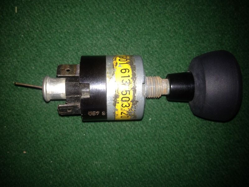

My new wiring harness I purchased from Kroon for my fog lights calls out an NR, N, 58 and ground for terminal installation but my 68 switch has a terminal ID of 1, 2, 3 and R and a light bulb which I believe gets grounded to the cig lighter. Which of my terminals is the NR, the N and the 58? The diagram switch part # starts with 914 and mine is 901. I think the one on the diagram is for a later year.
Bob

That diagram is not for a Porsche, at least not a early one. They had only one fuse block. It might be for a 74 on.
Your switch should be a two stop switch. the first stop is for the front fog lights the last stop is for the front and rear fog light (if you had one like the 69.) I believe, if I remember correctly, the head light switch was also used as a fog light switch.
The #5 fuse on the fuse block is for a the fog lights, The White/green wires are from the fog lights and the white/yellow wire goes to the fog switch. If you can find a early factory shop manual. It will have correct terminals hookup. Mine is stacked away somewhere in the garage, sorry
