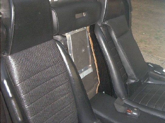

Removable Backpad to Access Engine
If you've been visiting all914.com, this issue is a rerun. But check out my removable backpad project, completed last weekend.http://forums.pelicanparts.com/uploads/fullseats.JPGhttp://forums.pelicanparts.com/uploads/hatch8.JPG

douglas robbins 03-14-2003 01:11 PM
Just to clarify, the little hole in the leather in the first picture is for the dome light. The large hole, (reproduced below), sealed by an aluminum panel, lined with screws, is how you access the engine compartment to change the fan belt and to manually crank the engine, using the alternator nut in order to perform a valve adjustment.
The reason why valve adjustments are such a pain in the ass in 914s is largely because its a ***** to turn the engine over manually (because the alternator pulley/crank pulley is hidden against the firewall. That's why people sometimes chip the fan trying to turn the alternator/crank pulley and that's why PP has recommended that you jack the car up and turn one of the tires while in gear. All of this is to get around the problem of hand turning the engine.

Ok, So you cut a hole in your firewall to do valve adjustments easier? I made a T out of a 2X4 and a 4X4 to hold one of the wheels while I turned the other one to rotate the enigne. It fits perfect between two lug bolts to hold one wheel while it is up in the air. With the marks on the flywheel I can see underneath throught the small hole in the case. Do a complete valve adjustment in about 15 minutes alone. Works great.

2 nails, 1 2X4 about 2.5 feet long, and one 4X4 about 2.5 feet long. Took 2 minutes to build and works great. I feel safer with the car on Jack Stands rather than taking the chance of rolling over or off a ramp. http://forums.pelicanparts.com/uploads/stilt.jpg

Mountain914 03-15-2003 10:14 AM
hey Douglas, I like it!
Here's some pics of mine. I haven't yet put a metal panel in, I have been flip-flopping between aluminum and stainless.
Makes distributor work, belt change, etc... much easier!
