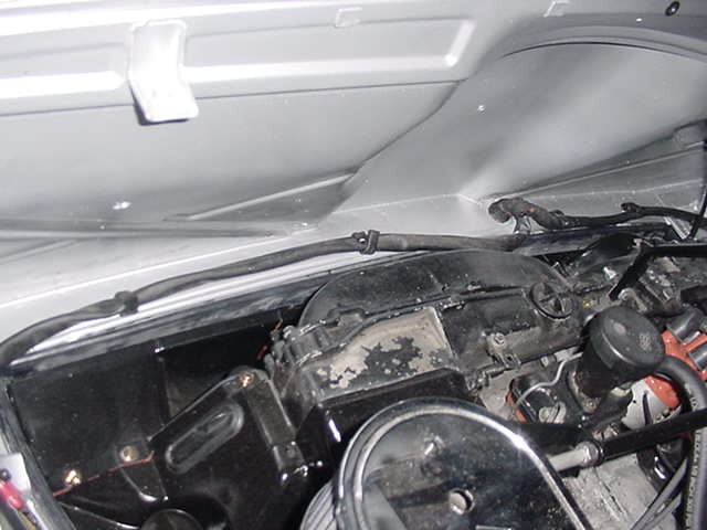

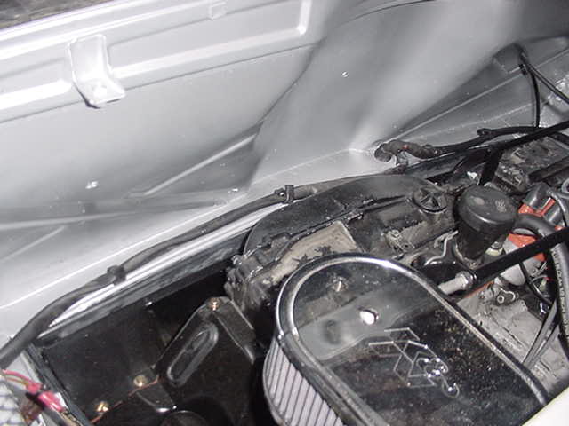

just a couple of shots of what mine looks like.
kevin

Jeez Kevin, that's so clean its almost sick...

Kevin, that firewall w/o sound padding looks very nice. Are you running no heat in that thing. Without the heat ducts the bay looks really clean. Damn, one more thing to add to the to-do list

will put the fan in. i'm a puss and want the extra heat heat, don't like the horse hair. thanks. the foil is a good idea!
