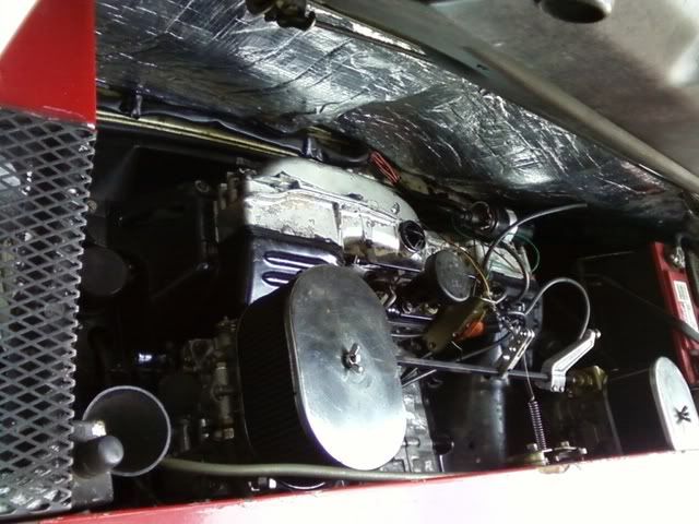

Do you happen to have any pics of you engine bay ?? trying to figure out the linkages and fuel line routing .. Looking for ideas

I have them on my car, not the best pic to see the fuel lines, but here they are.
